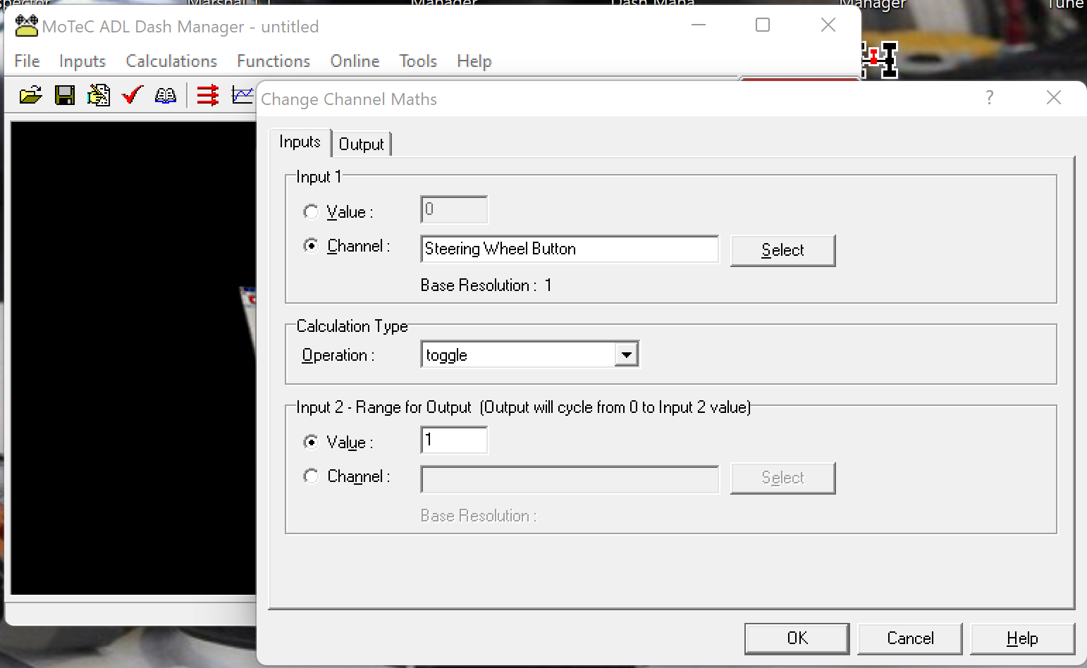

Postby NathanB on Thu Mar 24, 2022 9:08 am
You will need to handle the latching functionality in the dash.
If you are using an ADL, use the channel maths. Assign the button channel as the input and use the toggle function.
ADL Channel maths.png (126.49 KiB) Viewed 8564 times
The output of this channel maths will be your latched signal that you transmit to the ECU. Depending on the specific dash in use, set/reset user conditions or other functions can be used to achieve the latching function. There is no way to get the latching to happen in the M800.

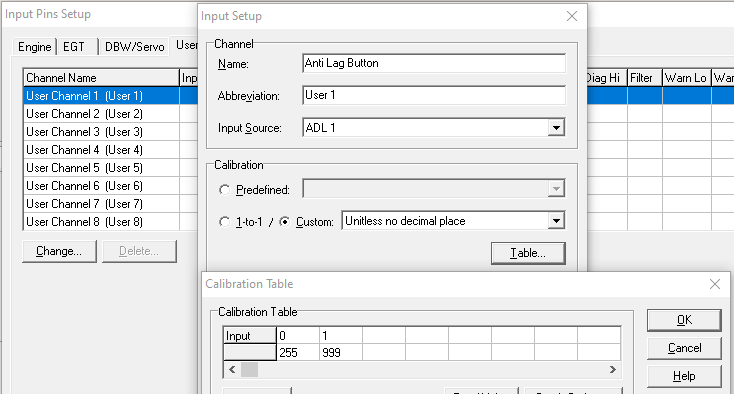

Postby RR213 on Fri Mar 25, 2022 4:10 am
It's a Tremondi SWP (steering wheel panel). I will look at getting the SWP firmware updated add toggle and up/down counter options.
For now it seems function 25, ORB Select is the only function we can toggle. From other projects I have done, that function requires a CAN transmitted hi/lo value in mV that satisfy the threshold and some hard coded hysteresis mV value. I've used 256 for Lo and 999 for Hi with levels set at 0.3 and 0.5 respectively.
Are you able to confirm if a Sw In using an ADK source considers the calibration table result or only the raw CAN value? In the past I've scaled this in the transmitting device so I think the raw CAN value is used.
