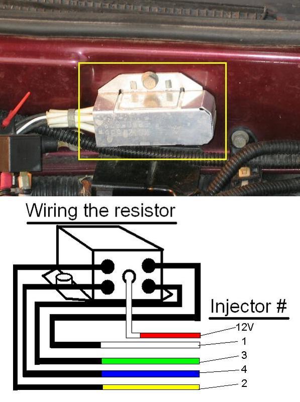

I think you have something like this on firewall.

so based on what i know is that...my m800 has 4 wires coming out for ignition and 4 wires for injectors rite? if so..how come in your pic..there is just 1 12V to the resistor? which means..i probably have 4 separate resistors for each ecu injector output? *puzzled*

Each ECU injector output is connected to one side of injector coil. Other side of injector coil is connected to resistor. Other side of resistor is connected to +12Volt. As you can see on the picture four resistors in pack have common +12volt.

Mazi wrote:I think you have something like this on firewall.
Dear Mazi, since when SR 20's have resistor pack?? I have one S13 and one S 15 and neither of two have pack. Have also client with SX 200 and he dont have neither! Please iluminate me! Would like to learn more since i have buncha of SR 20 DET's in my garage. Maybe they was been already modified before to come into my hands?? ( I dont think so.)

As far as I know it is common that resistor pack is added if low impedance injector are used and ECU is set up as for high impedance injectors. Car is not stock car.
