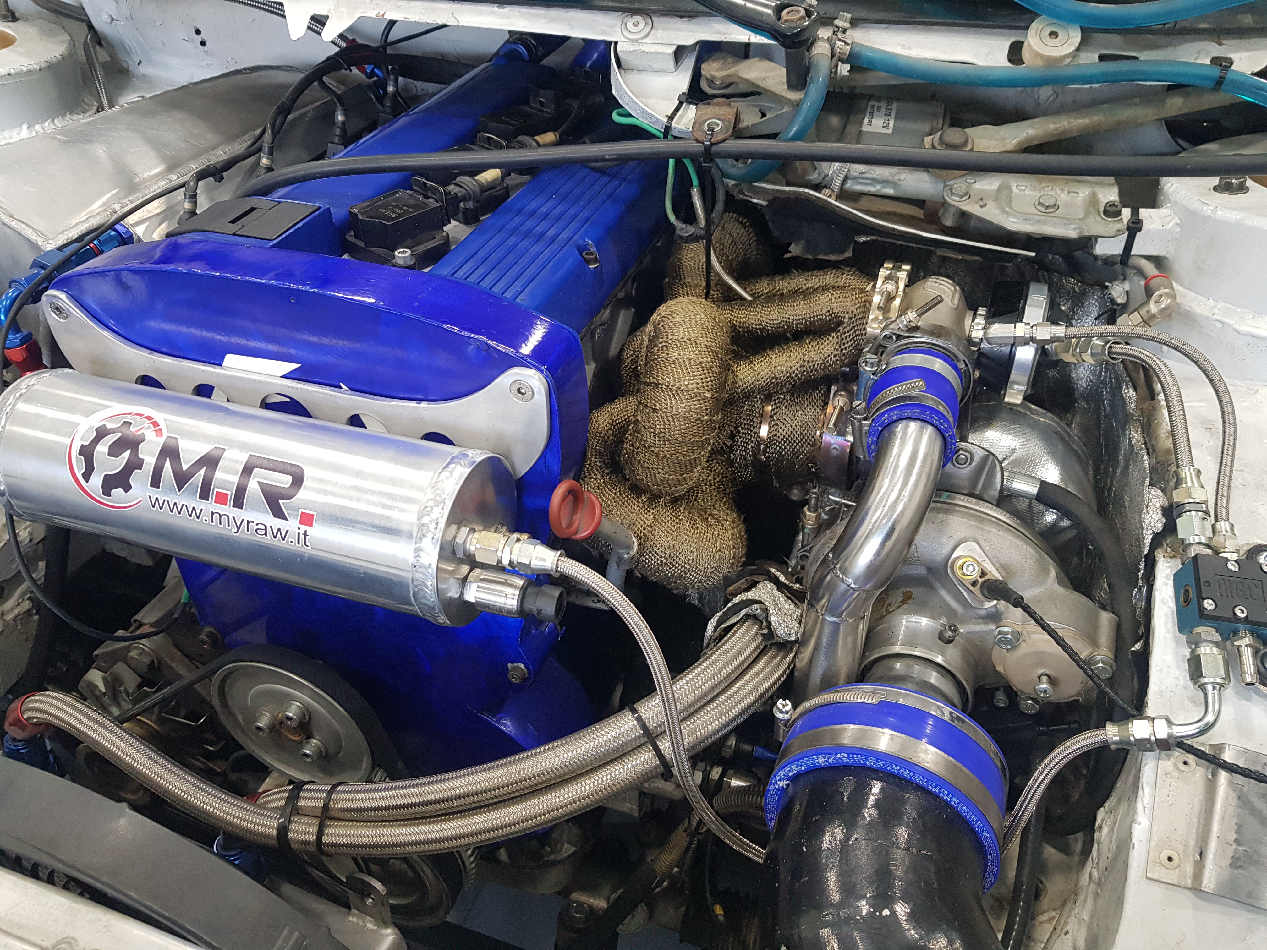

Postby MyRaw on Wed Oct 13, 2021 6:36 pm
I am attaching a current photo.
4 cylinder engine
turbo Borg warner efr 7163
valve for als turbosmart avl 40 with 20mm inlet air passage.
With the classic anti lag I kept the throttle 25 ° open .. with this system I will have to keep it open? or can the opening be reduced?
Als strategy:
-40 ° ignition delay
ignition cut-off 40%
fuel enrichment 30%.
I tried to move from these values ​​but to no avail.
I have a pressure sensor before and after the throttle.
I have an exhaust gas temperature sensor.
I have the turbo rpm sensor.
If you tell me specifically the data you need, I'll give them to you.
for now thanks for the advice
Fresh air punto.jpg (5.29 MiB) Viewed 8194 times
