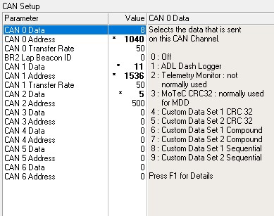

Where can i find some details on this, this is a Subaru N14, and the M800 transmits coolant temp via can, from a custom data set to the oem cluster. I have a 2010 Forester on which i need to fit a M800, and i need to send coolant temp and rpm over can to the cluster.

I have attached the installation notes for the WRX9-10 OEM replacement M800, if you can let me know the part number of the OEM ECU that was in the car I can see if we have a matching start file for it.

This car has a Goldbox M800. On the PNP one i saw the custom can messaging, and thought if i can do the same on this car, with the universal m800

I have sent you the files via PM.
