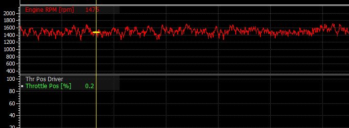

With ref to my previous post, has anyone experienced poor idle on a Hayabusa engine?, image attached.
Cheers
Steve

Is the mechanical condition OK? No air leaks, compression good, clean/new plugs, injector spray pattern tested.
Is it wired correctly? lower / upper injectors aren't swapped or something, injectors / coils wired in firing order not cylinder number.
Do you have any diagnostics errors on ref/sync, injectors or ignition?
Do all sensors values seem reasonable?
