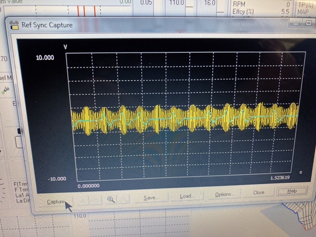

Am having cold start problems with my Ford Duratec 3.7l V6 on M800 emu, it fires but does not catch and run. I did a Ref/Sync capture yesterday and the Crank signal is very noisy, attached, is that normal or a problem with the sensor or the wiring please ?
Appreciate your advice.

More or less impossible to tell anything from the screenshots. Posting the log file and the ecu config will increase the chances of someone being able to help. From the ref / sync capture screen you can save the capture as a file, that may help too.

Ref sync capture looks tolerable to me, falling edge on both. The log file is the one with the .ld extension, not the .ldx

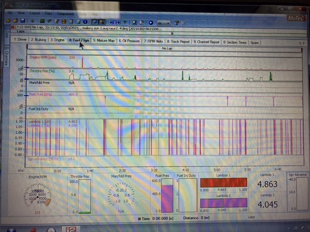

Of note I have fitted an aftermarket BBS throttle body, I have set Throttle Hi and Lo, 1 set, tho not 100% certain I've done that correctly, a sensor check seems to show its working as expected. It was a bugger to start from cold before, hot start was grand.

Dave, what's the story with the battery? Is the battery failing, or is it just flat and the starter itself is failing? I'm seeing lowest of 6 volts when starting cranking, seems to be averaging somewhere in the 8 volt range. I'm surprised it even syncs with that low voltage.
I'm assuming from the log file that you were cranking with the UTC plugged in and ECU manager open? If this is the case, with battery voltage that low it's possible to corrupt the file in the ECU when cranking. Try saving the current file, then doing a file compare with a known good file to check if this is the case. Also, with ECU manager open the errors don't clear themselves, so that the errors logged don't necessarily match when the channel was in error. Press E in I2 to display the errors.
Obviously I'm not familiar with your setup, do you really have no MAP, MAF or BAP (barometric pressure) on the vehicle? None are defined in the ECU file, which seems strange(ish).
I'm seeing some weird steps in the injector pulse width whilst cranking , starts cranking at 24 ish then partway through cranking it drops to about 6.5. It almost looks like it's trying to start, then the RPM hits the 600 rpm run threshold and it chops the fuel pulse width. As yet I don't know why it's doing that.

Yep the battery only seems up to about 6 attempts at starting, before cranking speed drops off. I dont think I had my jumper battery attached for the logged event, but will for the next post.

Yes, in I2 if you press E it will show errors in a pane at the top of the screen. Don't worry too much about the noise error, see what errors it gives when running.

Since we can get the M800 config from the logged data, I was able to compare the configs. The fuel table is vastly different in the low TPS / RPM regions. It looks like it just doesn't have enough fuel for the amount of air being it's getting. The old file had values like 30 @ 5% TPS / 500 RPM, whereas the new table has 15% at the same condition, which would be used right after it leaves cranking and starts running. So you've removed 50% of the fuel.
I noticed that when the engine was running the TPS was reading 4.1%, but all the failed starting attempts, the throttle now seems to be 5.5 - 6%. Perhaps you you might try closing the throttle stop, particularly as you now have a different throttle body.
I would suggest you methodically try changing the fuel in the 5-10% TPS / 500 - 1000 RPM cells. Increase all those cells by about 20% and try starting, charge the battery if necessary between attempts, stop if it's cranking slowly. Then repeat 20% again. Continue until the fuel table values are 35-40. If that doesn't do it, pull the spark plugs and make sure they are not fouled (might do that first!). Share a another log and we'll help you look.
Also, I notice your Fuel Cranking Comps are really high -- this is another sign that the fuel table is too lean in the cranking area. The Normal comps are around 250 max, and tapering off quite quickly. Revisit this once you get it starting, but I suggest you put the same values in the zero RPM cells as 500-750 and see if you can then reduce the cranking compensation.
