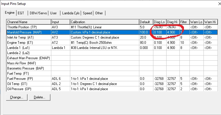

With it running you are actually seeing over 4 bar? Do you have logging from the ecu? You could up the log rate on the map to 20 or 50 Hz and then provoke the problem.
In the sensor custom table you have the highest table value at 4.89 volts and the diagnostic high at 4.90 volts. The low end of the table is also .01 volts off the diagnostic low. I'd maybe try diag lo at 0 and diag hi at 5.0 and see what happens.

Postby Lsi on Mon Oct 12, 2020 10:25 pm
Hi Sean, thanks for the reply, i actually lowered the value on low diag and the problem went away, it was happening when I was letting of the throttle.Now just need to sort the two separate issues. Thanks.

Postby Sean on Tue Oct 13, 2020 9:34 am
It's possible the rich cold idle was the map value defaulting to 100 when in error. If it's actually running/idling at (picking a number out of the air) 80kPa and the sensor channel has defaulted to 100 because it's in error, you'll be 20% rich based on the Adjust>Fuel>Compensations>MAP Comp table.

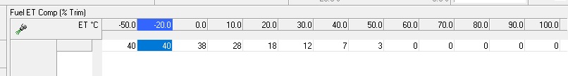

Postby Sean on Fri Oct 16, 2020 11:58 am
Are you 100% sure it's rich when it's struggling to cold start? Black smoke, lambda sensor reporting rich etc?
The reason I ask is that the one thing in your file that did stand out was the fuel engine temp compensation table has very little fuel enrichment when the engine is cold compared to anything I've seen. Picture is an example from a 2 litre turbo application.
