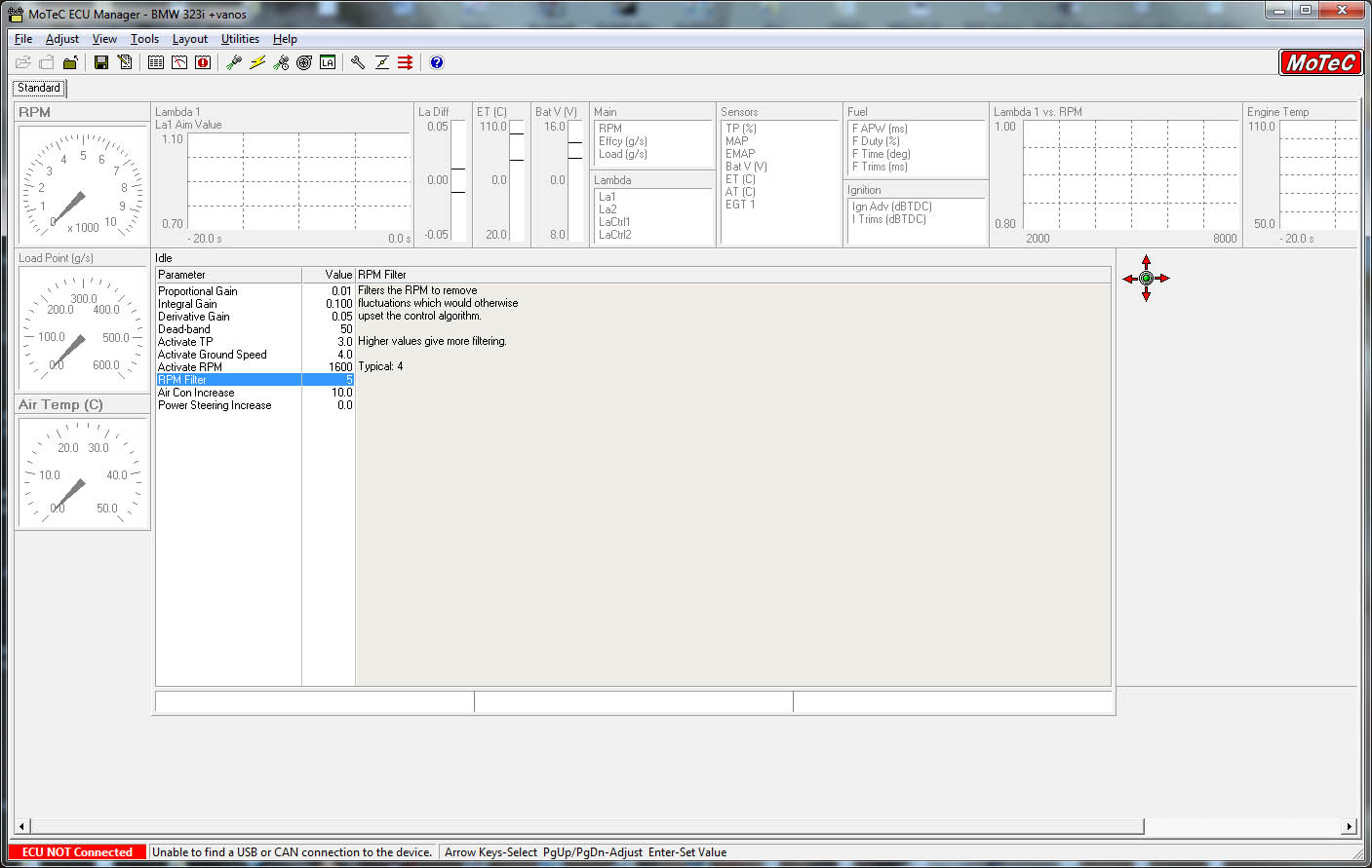

The throttle body is for the 3.0L version of the engine(M54B30) and I currently have it fitted to a 2.5L. The factory setup uses an IAC valve to do most of the work at idle(mixes IAC and DBW for idle).
Idle DBW.jpg (130.86 KiB) Viewed 14629 times
The fuel and spark tables are flat and tuned. It does have a fuel delay due to MAF based tune though. When P,I,D is all 0.0 idle is stable.
