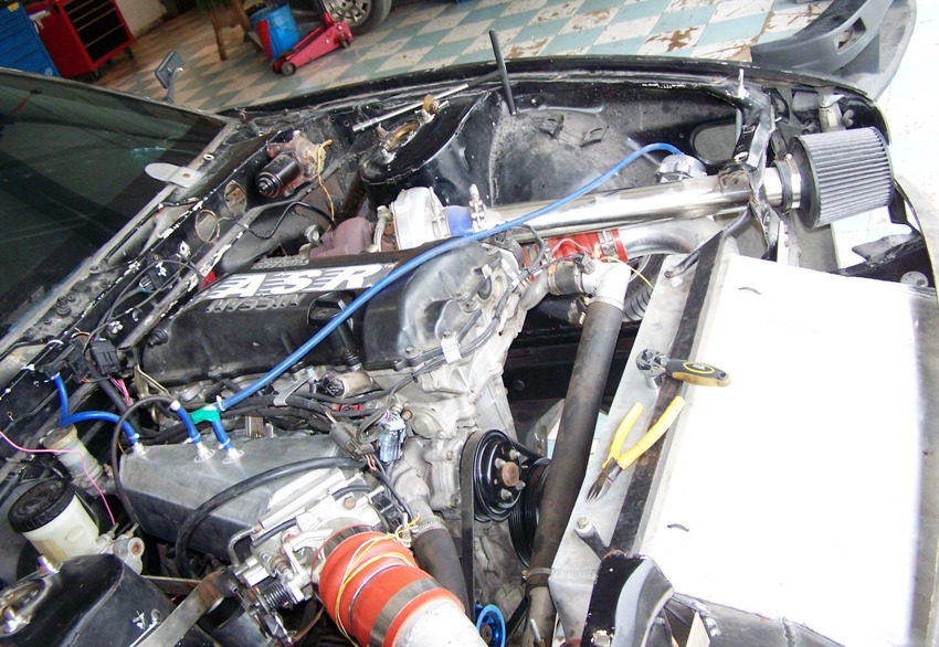

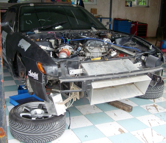

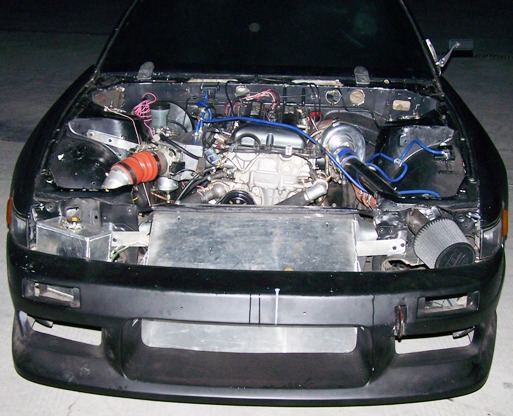

As for my ginition, i use igniter from Bosch, available trough MoTeC also and coils from hyundai i-VVT. Pritty good combo till now. Cant say for really serious power! Caution please, i do 382 HP on the wheel's. So carefuly about that. Not sure after i go for more that i will still use same coils. try to ask some of guys from forum more about good igniton for 400+ HP. I have also other SR20DET and doing around 420, igniter Bosch and again Hyundai coil's but this time from 2K cc engine. Using my custom build intake manifold and my own turbo with quite a lot of customizations. Rear water cooler, Short duct high flow intercooler and so on. Different water pump, diferent oil pump and few other stuff more.
P.S. Must have ignoter, you know that, right? Cant be wired directly to MoTeC!
Kind regards Pascal
My baby!
Big Aluminum intercooler intake dominates fron nose, so no space for water cooler. It's on the back!
llo ther on the wall, there is my Bosch igniter. Intake manifold, throtle body, exhaust manifold, intercooler and pritty much all is made in Art of Speed Racing.
