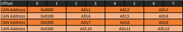

The hundred series ECUs receive compound messages, below is an image showing how the message needs to be formatted
Mx00 Compound Message Receive.png (5.83 KiB) Viewed 21291 times
The first two bytes are the compound ID and the ADL1 to ADL12 are all 16bit channels. The CAN address is configured in the Mx00 software and can be any standard 11bit address.
In the input for the wheel speeds you use ADLx as your sensor source.

The table above shows the only way you can receive custom CAN messages into a M800.

If I only send 2 of the 4 messages, i.e. offset 0x0000 and 0x0100, will the M800 throw an error for not getting the rest?

No it won't give you an error, you can send just one of the messages if you want.
