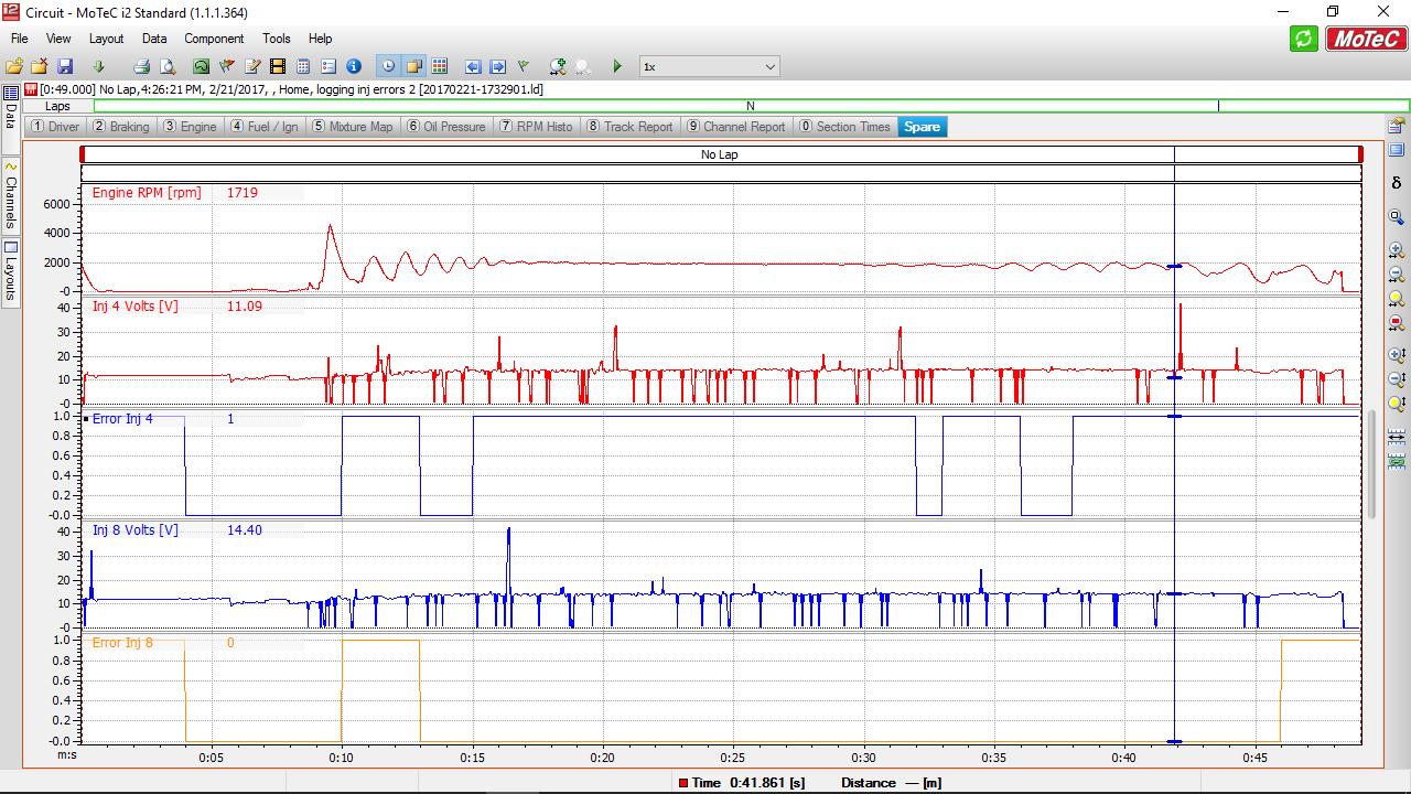

Thanks. Here ios a screenshot from i2 showing a couple of injector voltages with errors. Other injectors were fine. Not sure if this adds anything to the picture or not. I was told the voltage spikes are not abnormal.
maddog
Posts: 10
Joined: Wed Aug 12, 2009 9:09 pm
