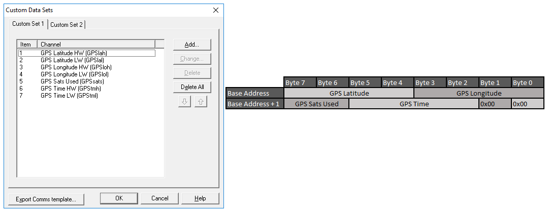

Re: m400 gps readout to gauge using can
PostPosted: Mon Feb 13, 2017 1:50 pm
by adrian
What information are you actually trying to send the gauges? If it is GPS Lat/Long then you will need to configure a custom CAN dataset in the ECU to transmit that information. It is not sent out in the default CAN output stream.
The below image shows you one way to set it up and what the message structure will be.
GPS Data Set.png (16.23 KiB) Viewed 18575 times
GPS Lat/Long are signed channels sent in degrees, decimal minutes. This is different to what you would see in the logged data which is decimal degrees.
