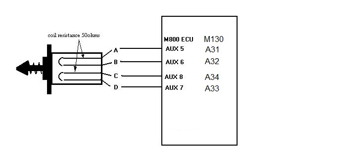

Should the two middle pins measure as Positive or Negative for the stepper?
I know this picture is from the MS Website, but it has an illustration that works for me.
My Motor is like the center item.
Thanks!

Postby MarkMc on Wed Nov 23, 2016 9:25 am
This is the diagram I always use for the GM style stepper motors. The idle control setup in your ECU looks basically correct except you don't need any integral gain at all for a stepper motor.
How are you testing this? The idle control will only work below 1500rpm, 2% throttle and 4km/hr ground speed according to your set up.
GM 4 pin STEPPER MOTOR.JPG (23.51 KiB) Viewed 12301 times
