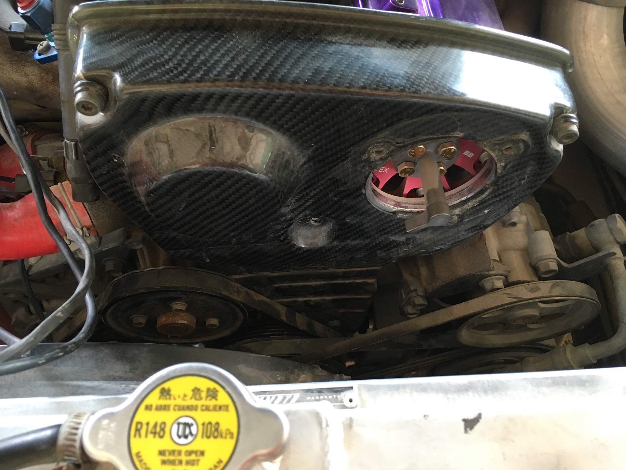

Thanks, by far the easiest to understand reply i ever had on this topic. Hope to see how it works out. One more thing i wanted to know and sorry for my ignorance, how do exactly set my engine to TDC 1 firing stroke? People say alot about winding the engine clockwise ( however doing so with the ignition key is so fast i cant see nothing and miss a few teeth) how do people wind a proper engine by their own hands? Never done this before, do they loosen up the belt or use a wrench to turn the engine while the car is off?
And this was cylinder 1 all the way up as i see, when i removed my spak plug off and away.
That was how the engine looked like when the 0 degree mark pointed upwards.
mfalah
Posts: 28
Joined: Mon Sep 28, 2015 10:35 pm
Re: Ref/sync not Synchronized.
Postby SprinterTRD on Mon Oct 19, 2015 12:24 pm
This "use a wrench to turn the engine while the car is off"

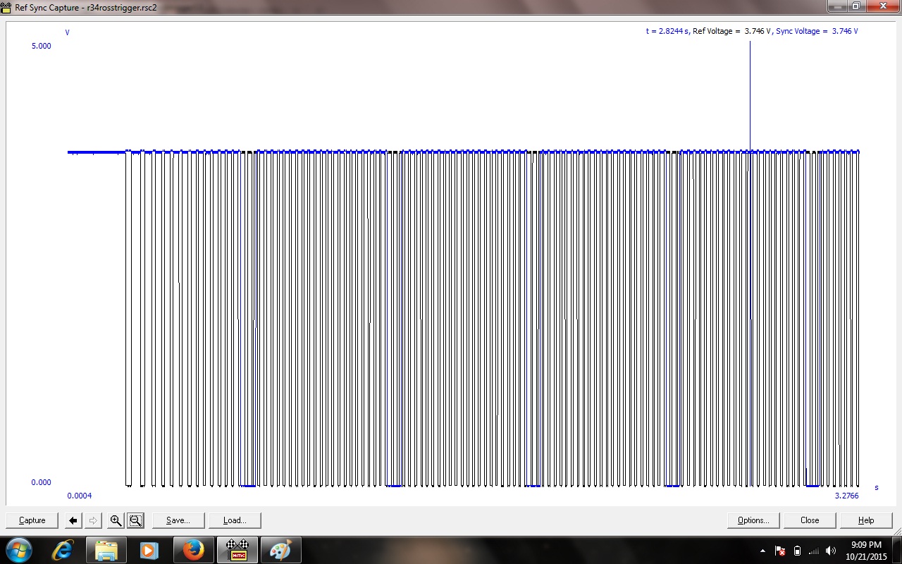

Postby abdo28 on Thu Oct 22, 2015 3:52 am
hi i got the same trigger kit and same problem but is start the engine but still something is not right
the ex manifold glow red after driving
abdo28
Posts: 6
Joined: Sun Jan 29, 2012 10:03 am
Postby abdo28 on Thu Oct 22, 2015 4:12 am
and this my capture
abdo28
Posts: 6
Postby David Ferguson on Thu Oct 22, 2015 9:27 am
That looks like a picture of the capture.
Try uploading the file r34rosstrigger.rsc2, so others can look at it in detail.

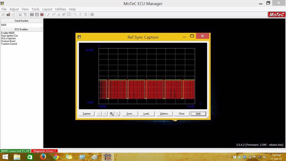

Postby mfalah on Thu Oct 22, 2015 8:27 pm
I have taken two captures at two different events.
Ref type: multi tooth
Number of tooth: 12
cRIP: no idea
Ref voltage :0 as advised
Ref polarity: rise/ fall but never fall if used on sync as advised by motec
Ref type: hall
Sync polarity : rise or fall
Sync voltage: 0,
Sync type: hall
Sync offset: 360÷1=360
Sync position: exhaust cam.
Now what is wrong?
Old capture with zoom out
Next capture with -1 to 10 voltage as advised by motec.
mfalah
