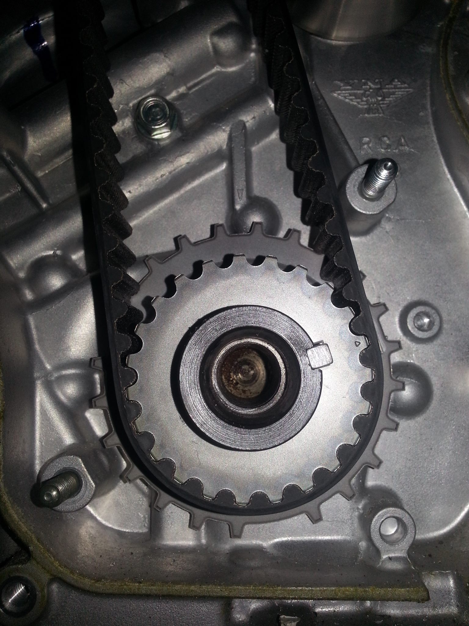

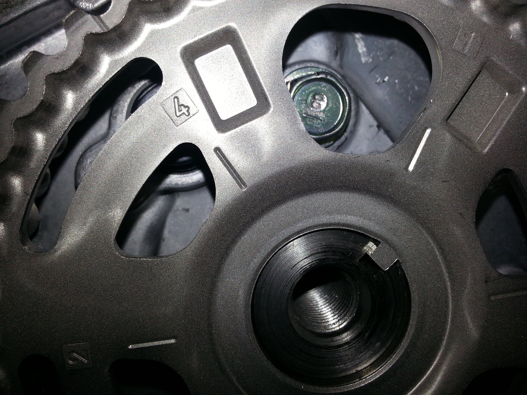

i'm going to use an Mxxx ECU on this Honda V6 engine (j35a8) inside a drag Civic car.
The Crank sensor is a 24-1 and the cam sensor has 3 teeth (pic below).
What setting i should use? at TDC the cam sensor is on the "4 cylinder" teeth on the cam pulley.
Thanks to everyone in advance.

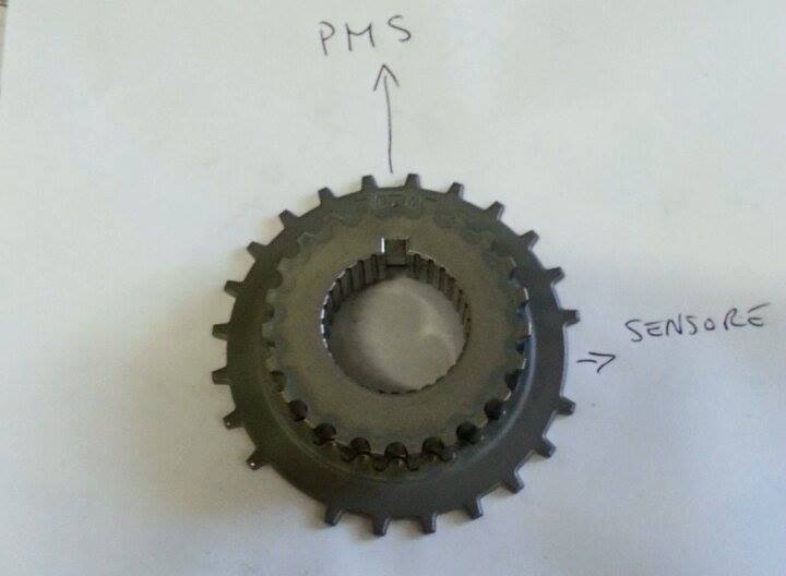

UPDATE:
Since i'm making a "remote" setup i didn't know that the crank is actually a 22 teeth with 2 missing in 2 different place.
The camshaft is a 3 teeth sensor.
I'm thinking... cut the teeth on the crankshaft sensor and leave just 12 equal spaced teeth and cut 2 on the camshaft sensor leaving just 1?
picture below... and thanks another time
