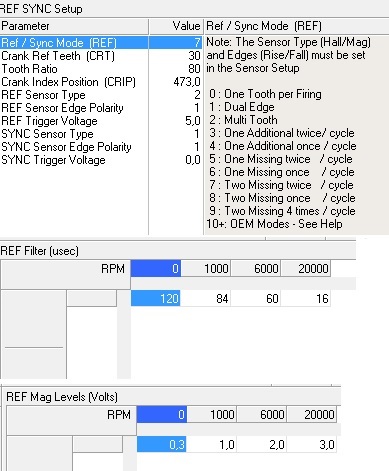

Postby sarbetto on Sun Jun 08, 2014 4:58 am
These are the screenshots of the settings
