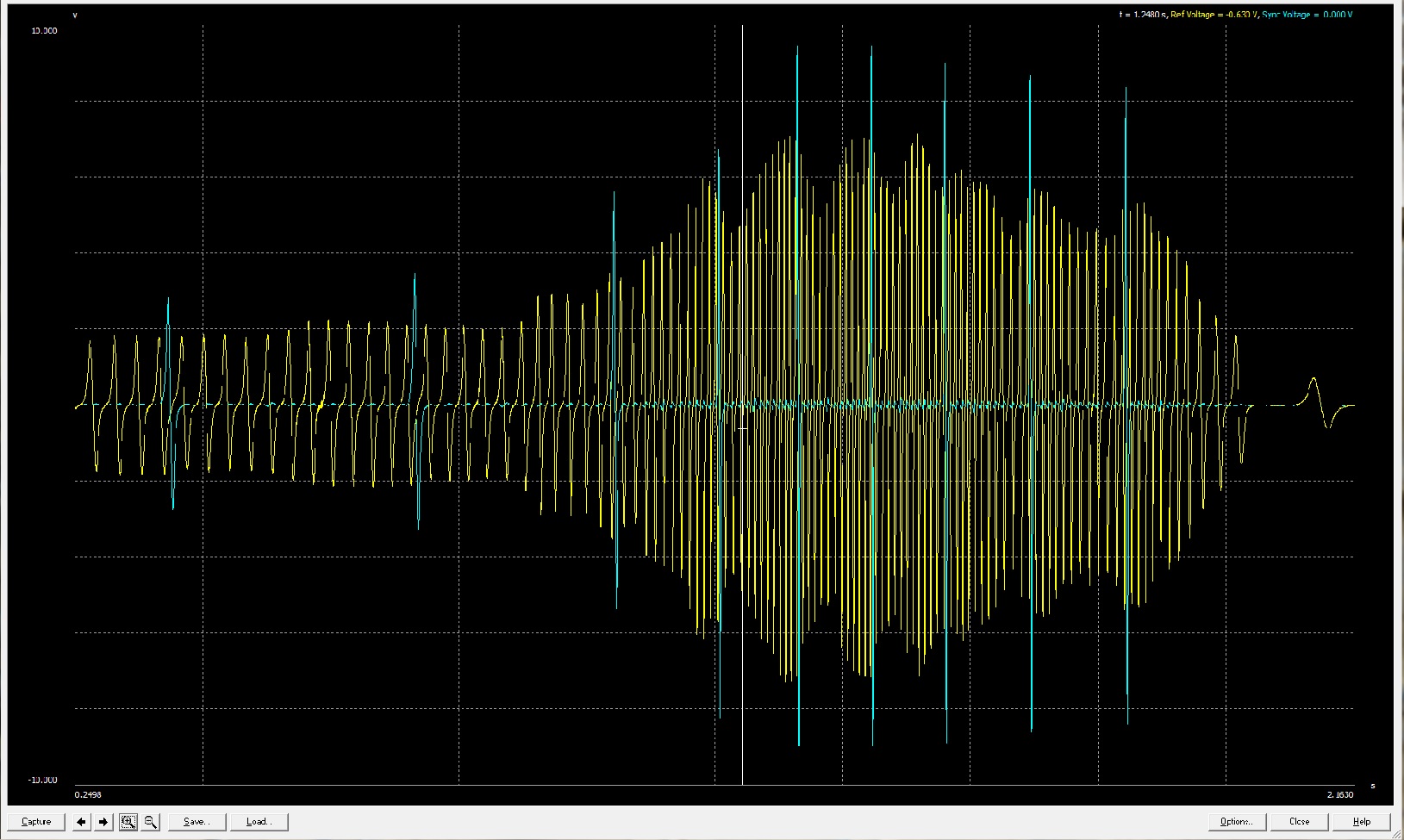

Postby FD3SRS on Sun May 18, 2014 8:46 pm
All sorted.
Started it today. FANTASTIC! sounds good. I need more mufflers!
A few little leaks to fix then it's off to the dyno at JTune.
How can i add a dial gauge or a chart on the layout that shows A/F instead of Lambda? I can't think in lambda.
I can't see how to do it anywhere else...
I tried to attach a ref/sync capture but i get a message that that type of file can't be attached so I've added a jpg screen shot of it.

Postby AdamW on Mon May 19, 2014 8:46 pm
Yeah, as suspected I dont see any reason why your stock triggers wont work fine, that capture looks completely usable. A little cross talk on the sync signal but not much amplitude to it.
There is no true way to use AFR in the ECU manager. You can actually scale the sensors to display in AFR but then none of the lambda based functions like "Q" & "L" or closed loop will work. For logging with i2 you could display it as AFR using a math channel, but I suggest you get used to Lambda, especially with N/A engines you really only need learn one or two lambda 'sweet spot' numbers so it shouldnt take long to retrain your brain to think that way. Its probably also more relevant with the modern fuel blends we see today.
