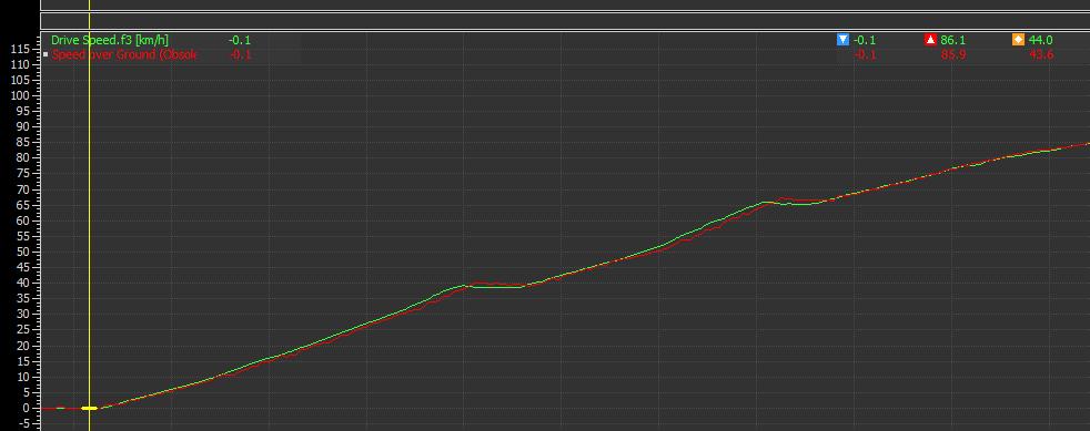

have a look..
Gps vs drive
You can see the drive running away from GPS as there is more slip just before each shift, but the delay isnt too bad is it?
gps vs drive.jpg (41.12 KiB) Viewed 23815 times

IDP & Martin (or others), I'd like to hear more on your thoughts re using GPS as a velocity source for TC/LC.
Martin, is the above graph using one of the Motec GPS modules, or something other? I know that GPS technology generally involves a latency time depending upon the system & satellites available, and that this can be compensated for during post analysis.
However, during live analysis & decision making, how big a deal is this? Can a person use either of the Motec modules live for such purposes, or would something like the RaceLogic V-Box be required (or some other product) for the purpose of fine TC/LC control?
What about going back to basics and simply integrating the longitudinal X-axis chassis accelerometer signal? Would that work adequately since we will be operating essentially along a horizontal plane and essentially along a straight vector line (hopefully)?

Yes it was with a 10Hz or 20Hz GPS module as sold by Motec. As you can see the channel that i used was an "obsolete" channel but that was just because the ADL sent the GPS data. As you know the ADL is a 16 bit device and not 32 like the ADL2, SDL etc...GPS`s arent fully compatible with the old ADL`s. The SDL, ADL2 are no problem.
Have a look at the logged data and then you decide if the latency is a problem....i dont think it is...From the ACL you can transmit up to 100Hz
I would definately try the GPS! Get the RS232 output from the GPS into the ACL and then you make a Custom data set and send the GPS speed channel to your M800 via Can bus. In my opionion Can bus if fast enough for TC and LC since ive done it with good results! GPS`s allready incorporate G sensors to decrease response time and increase position update rate. Novatel has really nice GPS`s with 200Hz Data output and up to 20mm accuracy but they are just too expensive. My sugestion is to try a 20Hz or even a 10Hz. Drag strips are usually open places with not much to block Satellite signals.
