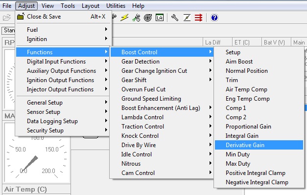

I'm sorry if i am being silly, i'm not blind, but i could not and cannot find it anywhere, could you please point me in the right direction ?
Also, i forgot to mention - i do not want the ECU to cut boost (it has to be an ignition or a fuel cut), because the thing that i am trying to safeguard against is a failure of EWG control.
I am using an air injector to control boost and when those guys go, they allow the EWG to stay shut from the turbo pressure itself, as they operate in an opposite way to boost control solenoids.

Postby Pavlo on Tue May 21, 2013 7:05 am
It's in Functions->Boost Control-> Setup
Stop being a man and look properly.
