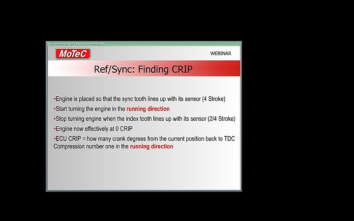

Do you happens to know the CRIP for the c20xe engine, I have measured it like this:
Cyl 1 at TDC, turn the engine in it running direction, until the index tooth(First tooth after tooth gap) is aligned with the sensor. I got 245 degreees, so that minus 720 is 475. I just dont think it is right, the engine startet, but not very good. If I alter the overall ignition trim it doesnt make things better. Unfortunately I didnt had more time last night to try other settings, but if you could tell me that I am way off, no reason to spend time:)

Postby Chris Wilson on Sun Aug 07, 2011 5:18 am
From a Webinar I think:

Postby Arve Flaat on Sun Aug 07, 2011 7:33 am
Hi
Normally the CRIP on a C20XE is 60.
Disconnect all the injectors.
Set the ign table on low RMP to 0
Attach a ignition lamp in ign 1.
Crank the engine.
If it is right you hit 0 on the engine marks.
If it not is on 0, adjust the CRIP so you hit exact at 0.
