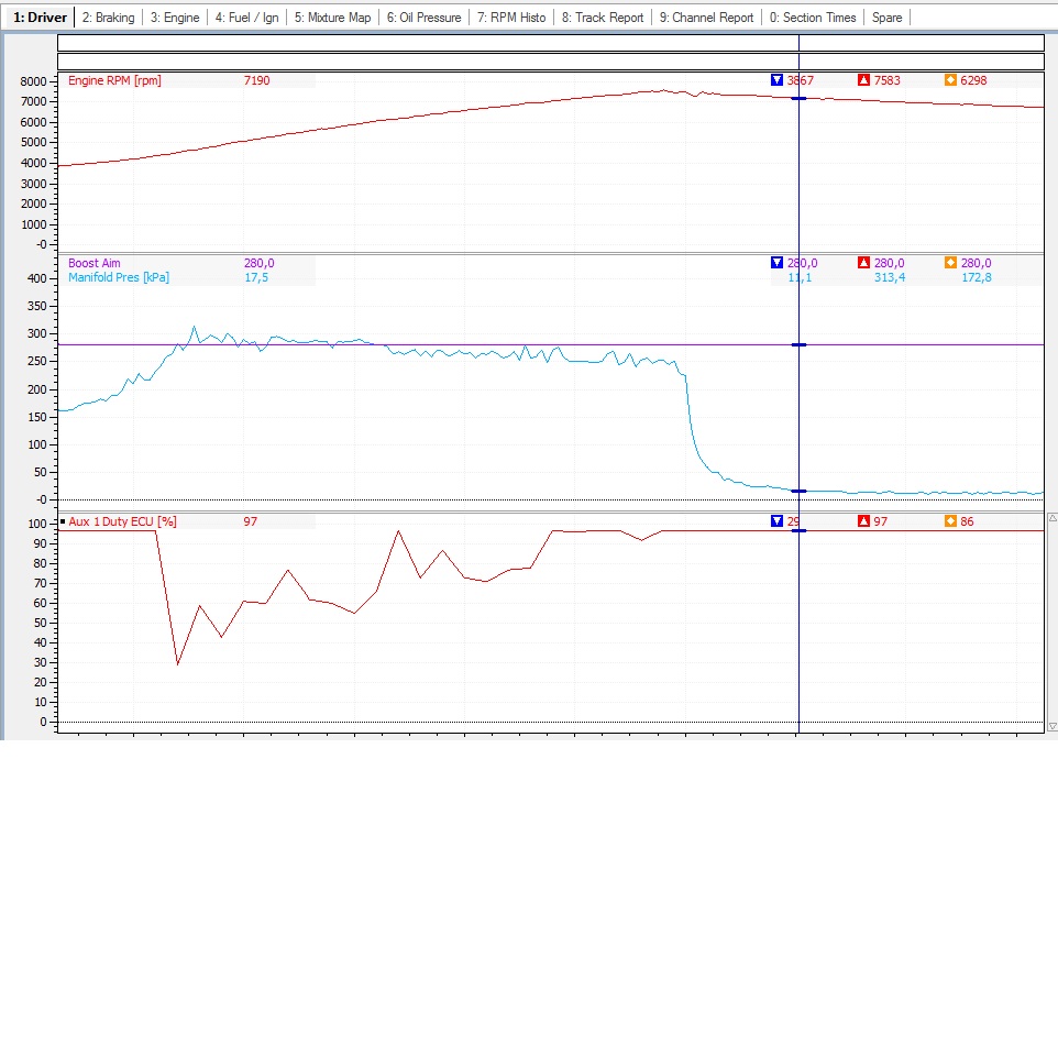

Dominik,
I would spend a lot of time doing a normal position on the open loop mode before turning the PID on.
I have found that the best my normal position table is, less effort is left for the PID to do it.
Usually I create a table on normal position with the X-Axis RPM Based and Y Axis according necessity.
Attached is a log from a car that I finished last week, with on P at 1, beginning the PID tuning. However I have spend a lot of time working with the normal position.
I hope this information helps.
Log File
New Picture.jpg (224.09 KiB) Viewed 9093 times
