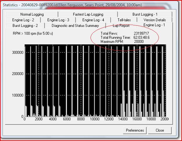

Is it possible to display the actual TIME and not just the percent in the RPM histogram?
Re: Engine Run Time
PostPosted: Tue Mar 15, 2011 1:23 am
by David Ferguson
Like This?
total time shown.JPG (72.51 KiB) Viewed 18289 times

That's great, but which program is that?
Yes, total running time is what I'm after, but also running time per RPM site on the RPM histogram.
I know its there graphically, but is it possible to get it displayed without having to export to Excel?

by Spinner
OK, I installed old interpreter, but when I open a logfile and press the Engine log tabs, nothing gets displayed. Am I missing something, or is it not able to display newer file versions?
