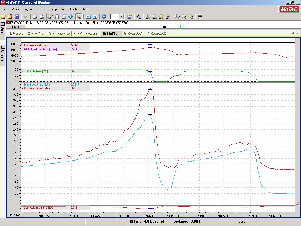

Postby pnanassy on Sat Sep 13, 2008 5:28 am
Measure it.Here is mine:

Re: Back pressure
Postby pnanassy on Sat Sep 13, 2008 9:26 am
Same as MAP,4 bar motorola IIRC.Connected with 30 cm steel brake line than 1m rubber hose.Works like a charm so far.
