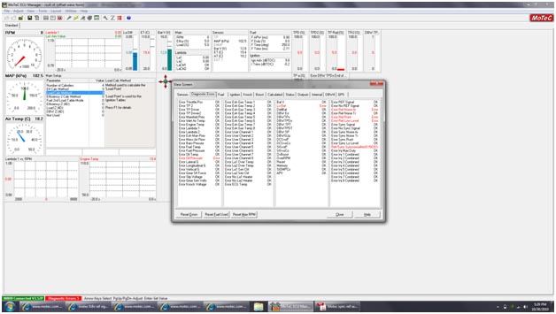

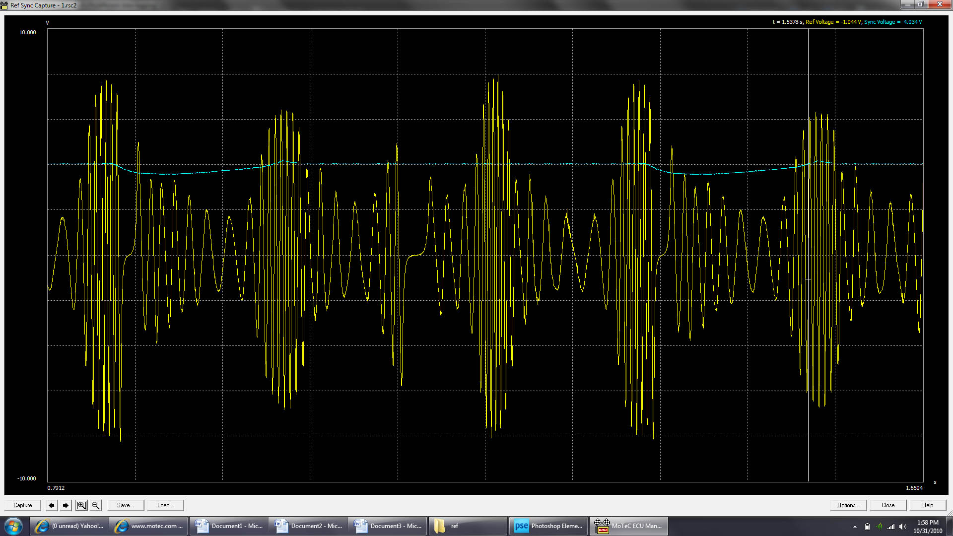

I have been unable to properly synchronize the ref/sync signals on my race bike. I am using a MAP sensor (off cylinder 1) as a sync sensor using Ref/Sync Mode 65. However, upon cranking the engine I get a ref runt and ref low level error (see below). Also, the ref signal exceeds 10Vs on the positive side and is cut off on the ref/sync capture (see below). Any suggestions on what I need to do to fix this?

It looks like you have wired the Ref sensor incorrectly, if it is actually a magnetic sensor then it should only be connected to one of the sensor 0V pins and the Ref input pin. When the teeth on the crank trigger pass the sensor the voltage should then oscillate above and below 0V.
The ref and sync inputs can take more than 10V, however the signals to the internal electronics are capped at 10V.

I still see a Ref Runt and Ref Noise Ar error and Ref Low Level error, but they disappear if I reset errors during cranking and only reappear when I stop cranking. Is this a problem?
Finally, after fixing the ref sensor setup, I am getting two new errors and the ref sync signals still won’t sync. These are the Sync Signal and No Sync Signal errors. I am using the MAP sensor off the front right cylinder. It is wired to the Sync input, 5V ENG, and 0V ENG. Any suggestions what the problem might be?
RSV4 ref-sync capture (fixed ref sensor, 1 cycle).jpg (309.06 KiB) Viewed 11681 times
