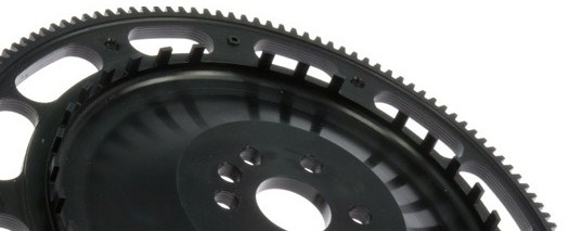

The tabs on the back of this (Non-Fezza) flywheel are used to provide magnetic or hall trigger.
Do you have anything like that on your flywheel?

No i don't...it's a regular flywheel

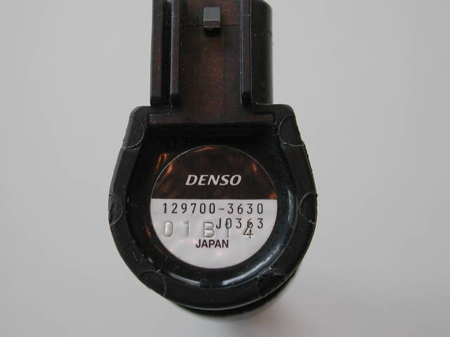

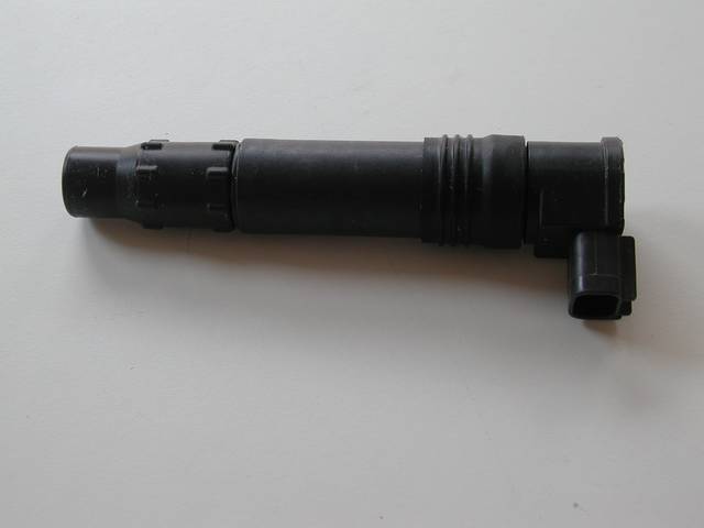

I'm using the COP's from Denso found on motorcycles. Perfect fit and length for my application.
Tommy
