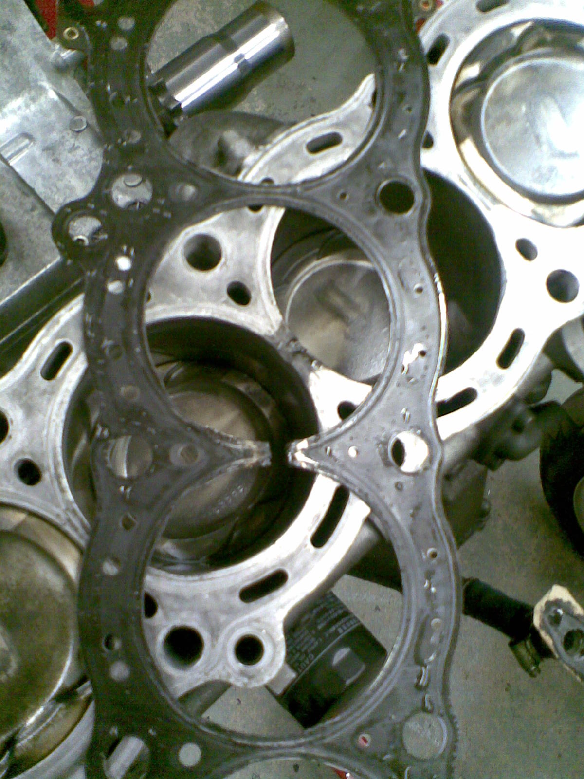

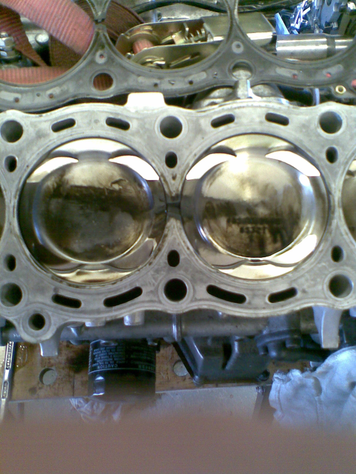

Postby harold on Thu Aug 28, 2008 4:47 am
Please see the attached, the motor has a 2mm spacer plate under the barrel, the piston's are wiseco, each time the motor has been built the barrels were honed with new rings, the scrapper ring gapped at 22 thou, compression at 20 thou, cometic head gasket, 12mm studs at 75ftlb. The fuel I use is VP Racing C16.

Postby RossB on Thu Aug 28, 2008 10:58 am
This damage is caused by a head gasket failure, once the gasket has failed the hot gasses have eroded the top of the block (and possibly the head) away. I couldn't really say what has caused the gasket to fail, it could be caused by detonation or it could be that there is poor clamping pressure on the gasket.

Postby harold on Thu Aug 28, 2008 4:32 pm
I agree with what you are saying, after the first failure I thought that maybe I made a mistake on the engine build so the second build the head and barrels were skimed to make sure they were flat and that engine lasted 4 runs with less than half the boost I was running last year. It has even been sugested that maybe the head gaskets themselves were faulty. The bike is being used for 2 days 6-7 September, I will post what I find

Postby RossB on Thu Aug 28, 2008 5:49 pm
I would suggest doing a cylinder leakage test before you run it in anger to check that the gasket has sealed properly in the first place. Then test again between runsso that if the gasket fails you can strip it down before it does so much damage.
