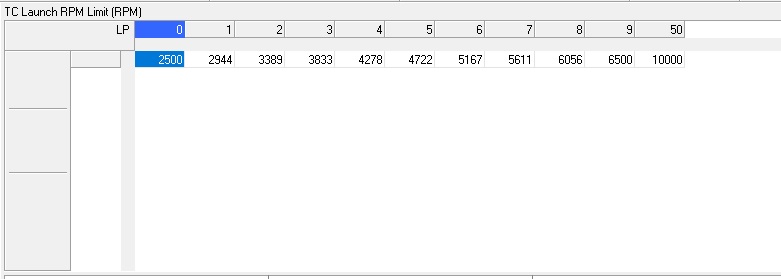

Your launch control has been nagging at me (and I couldn't help myself) so I got out a wiring harness , M800 and a few bits and did some testing.
If the TC disable switch is wired with the transbrake as we think, yes it will work, it will turn off the TC system and the engine will rev to high limit. It doesn't leave launch mode as far as I can see, just turns the TC system off. Needs to power cycle or reset the ecu to leave launch mode once it's entered.
In the supplied configuration, launch control activates only in dial setting 0 and 1 ONLY. This is because to activate the channel value (in this case dial setting) has to be below 1/4 of the maximum value. The reason 2 isn't accessible I believe is because 9/4=2.25, which rounds to 2. 2 = 2 so it's not below.
To access all the settings in the launch rpm table you can do a mod to the table, adding a value of 50 as the last value. 50/4=12.5, which rounds to 12, which is greater than 9.
Kev table mod.jpg (23.71 KiB) Viewed 8084 times
Do you have logged data from these runs? Boost settings appear to be 2 = 8 psi, 5 =21 psi, does this seem right?

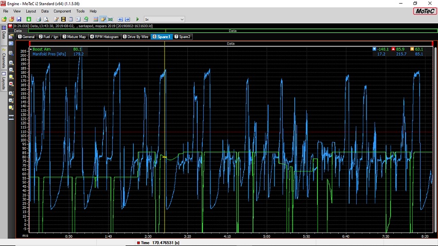

Kev, next question, does the boost control actually work? In the logged data supplied it appears not to. I will add the qualifier that I know not much about the Motec boost control system, however......
At one point target boost is 57 kpa (8.2 psi) and actual boost is 216 kpa (31 psi), that is 159 kpa (23 psi) over target.
See plot below of aim boost versus manifold pressure.
kev boost.jpg (189.61 KiB) Viewed 8066 times
Sean
Posts: 258
