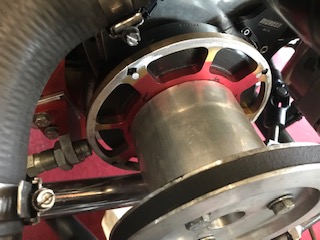

Is that an embedded magnet trigger wheel? It looks like the sensor is also reading the ring.
A falling edge on the Ref and setting the Trigeer Voltage to 1V may work, it depends on whether that bounce increases with engine speed.

Stephen, yes, that's an off the shelf MSD embedded magnet trigger wheel and pickup. Normally used with something like a MSD 7AL. The trigger wheel and the round pins are aluminium.

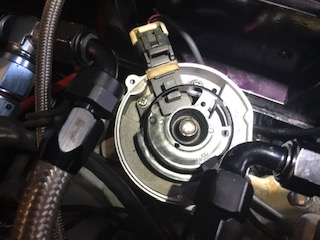

Kev, the picture of the ECU has answers one question, it appears to be an M800 rather that an M400. Can you post the actual configuration file from the within ecu please.

Sean, Steve sorry about that youre right it is a M800. I am checking everything I can think of. I just cant understand how it can fire and run with the Sync , No Sync errors. If the cam and the crank are in sync how does it run? Im a bit confused!
