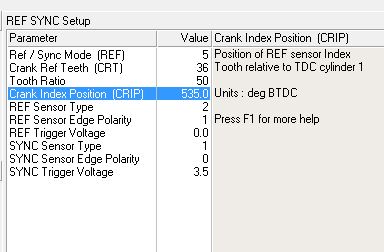

So i have now a REF signal
I also have a sync signal
i have got a CRIP which i believe to be correct
the injector and Coil are not cycling.

the cript is 360 deg out because it is to the next TDC of compression
Sorry that number has since been changed to 175 deg

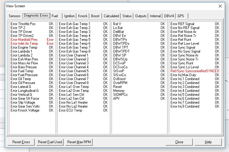

Postby Matek0012 on Tue Dec 19, 2017 11:49 am
updating the latest capture
But i am still getting an error regarding the rev/sync not being synced
im also not getting ANY pulses to the injector or to the coil

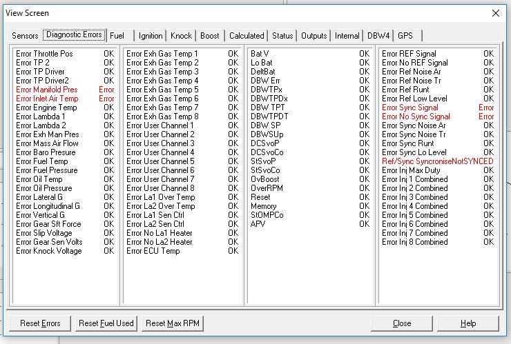

Postby Matek0012 on Tue Dec 19, 2017 11:54 am
And now this has just happened
