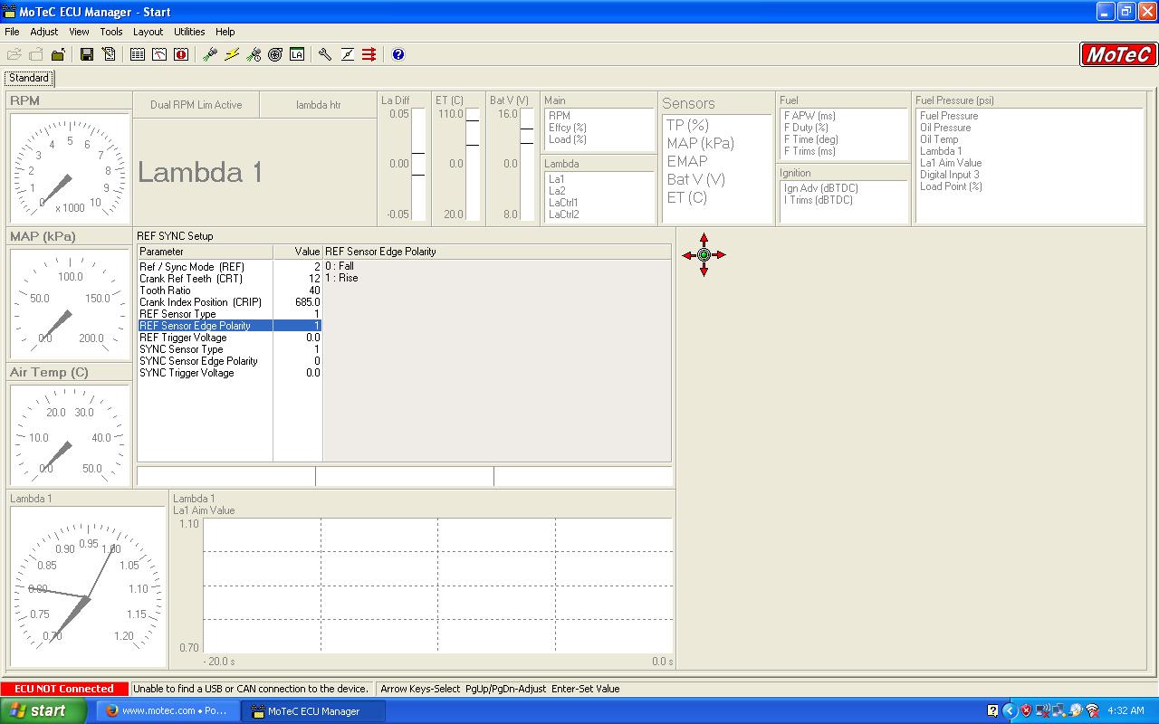

Postby mfalah on Sat Oct 24, 2015 3:15 am
I am uploading my tune, extension type which shows the capture is not allowed but i will be more than happy to mail that file to anyone that pleases. I have also the screenshot of the sync position setup so that you can correct me if i am wrong.
THE SYNC CAM POSITION SCREENSHOT
Sync cam position.jpg (247.84 KiB) Viewed 16771 times

Postby abdo28 on Sat Oct 24, 2015 9:40 am
hi this setup is for variable valve timing you don t need to use it
you try to use the setup up that i post but one thing to do is the
cam sync sensor housing you rotate it full clockwise so you have
the adge polarity for ref rise and the sync fall and the using
timing light conform the crip
