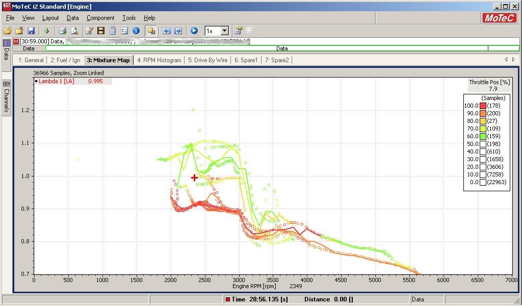

Progress!!
Last weekend fitted up the wideband and wired in a map sensor...
as you can see below... Toyota tipping it all in above 3000rpm since 1978...
swaped engine temp to an AV in and it seems ok, may still fit a stand alone delco sensors for ET and AIT...
managed to get it to idle with the motec controlling fuel so very happy with that!

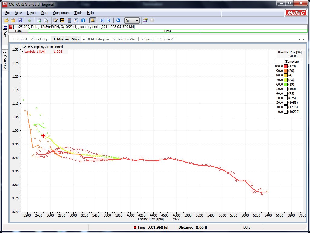

Postby Allan L on Mon Oct 03, 2011 2:26 pm
Well I have now got it running on the Motec controlling fuel only... cold starts not bad, hot starts not bad, nice lean cruise and not so rich under power...
getting closer... (still rich up top until it gets ignition and on a dyno..
still need to play with accel enrich..
