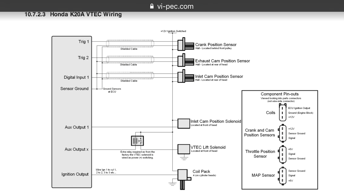

It is the Honda K20A that I working on, can you help to advise which voltage supply for its ref/sync sensors?
Also attached the K20A ref/sync sensors drawing that I found on internet, I'm confused why it stated 12v on power supply?
Thanks a lot.

Postby gtihk on Mon Nov 19, 2018 1:15 pm
They are Hal sensors. You can either use unregulated 12v or 8v.

Postby te37mag on Tue Nov 20, 2018 3:30 am
gtihk wrote:They are Hal sensors. You can either use unregulated 12v or 8v.
Thanks a lot for the advise

Postby gtihk on Tue Nov 20, 2018 2:00 pm
When I did mine, Sensor power was not coming from ECU. It does not really matter.

Postby te37mag on Wed Nov 21, 2018 12:28 am
gtihk wrote:When I did mine, Sensor power was not coming from ECU. It does not really matter.
So, to be clear, for sensor which need a 12v, I can get the power from 8v engine supply on M800 or also 12v unregulated supply? Is this also correct?

Postby mfalah on Thu Nov 22, 2018 6:59 pm
Hall sensors use 8 volts. ground pin is B16 or sensor 0 volts, signal wire you know already. use shielded cables or ecu will be easily confused with the signals and join the braids of the shield into the ground 0 volt. or you will see what ark design did to their r32 gtr :lol:
