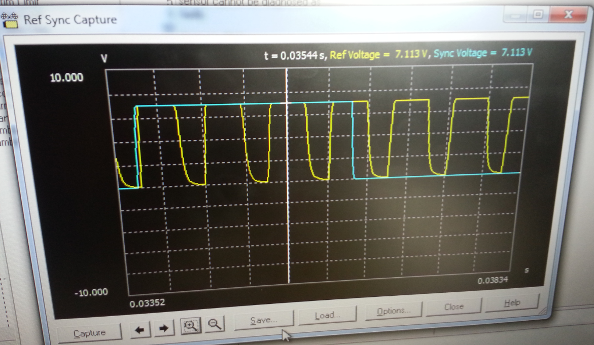

Missfire happens, and the ref sync capture shows an extended sync pulse (could't upload the fiel, therefore I took a picture).

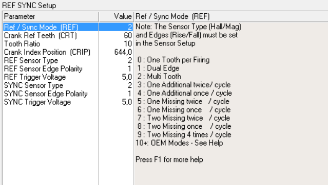

Ref signal by Hall sensor and gear ring with 60 teeth, sync by Hall sensor and one defined pulse. The ref/sync configurations are also attached.

Arve is wrong with this comment. A Hall effect sensor can work perfectly fine with a 60 tooth wheel provided the sensor is designed for it. Many OEM's use this combo. Perhaps he was talking about some of the generic Honeywell or cherry industrial sensors which often aren't fast enough?
Your wave form is quite distorted so that gives the suggestion it is not fast enough. What is your sensor - is it oem and matched for the wheel?

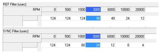

No. I use a SICK Hall sensor that should be capable to deal with the 60 teeth up to 6000 rpm because of 8 kHz, but in fact it doesn't :(
At 1000 rpm everything works fine, the ref signal has a nice square shape (for both! magnetic and hall configuration in motec ecu). At 1700 rpm the nice shape is gone, triangles appear now as ref signal (in case of hall configuration) and in addition this bad signal even isn't stable e.g. the sensor can't recognize single teeth in some cases so the ref signal stays high while 3 to 6 teeth are passing the sensor (happens for both: hall and magnetic config.).
