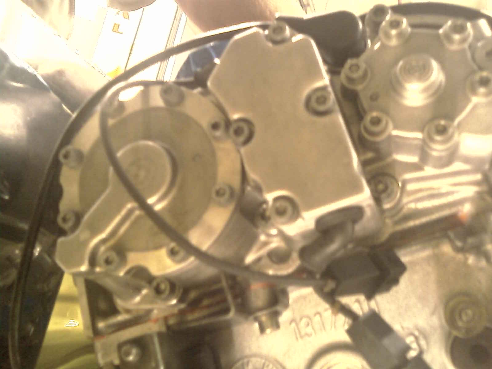

Postby Martin on Fri Nov 21, 2008 7:57 am
Hi
Thanks for the offer DynoT, ill take you up on it. Ive been to the car today, its a S50B30
Here are 2 pictures of what the engine looks like, specifically the Cam control part of it
Top View
Front View
Re: BMW E36 M3 (single vanos)
Postby Martin on Fri Nov 21, 2008 7:59 am
Sorry about the poor quality, one cant see very well when its posted
