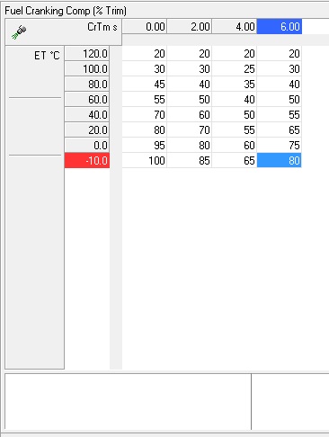

I am having problems with starting my car, the colder it gets the harder it is to start.
Last week it was 5C outside and i had to crank it for 30 seconds to get it to start up.
This week it is -1C outside and i could barely start my car today, had to bring in a battery charger and crank it for a minute before it finally started. I'm afraid i wont be able to start it again if it gets any colder (and it easily gets to -20c here!)
I recently relocated to a colder climate and have not yet found anyone here, who is proficient enough with motec, to adjust the map for me.
Could someone please explain to me, whether i could do something about it myself (I have the can cable and the motec ecu manager installed on my laptop, but mainly use it for diagnostics), or is it something more complicated than that and requires attention of someone with experience?
If it is just a matter of adding a few values with lower temperatures to a table, could someone please point me in the right direction ?
I use Motec M800 gold
Thanks!

Thank you for your response, attaching a picture of my cranking compensation and my whole configuration file, let me know if you have any suggestions, thanks!

This is your cranking comp table.
How is your engine temp table?

I agree with the direction that Arve was going. I would have expected the engine temp comp on the base table to be twice as big. However, it depends on what the engine is doing when do try to start it. It doesn't fire? It doesn't stay running? . . .

Here is the engine temp table.
It's both really, it fails to fire up for the first minute, then once it fires up it stalls and then i have to fire it up again and hold the gas pedal in for a second or two to let it come alive, then it's fine.

Postby stevieturbo on Sat Oct 27, 2012 9:28 pm
I'd easily be doubling or tripling those numbers in the coolant enrichment table
Also fill in some values for colder temps too in case you see them.

Postby scoobyman on Sun Oct 28, 2012 11:14 pm
stevieturbo wrote:I'd easily be doubling or tripling those numbers in the coolant enrichment table
Thank you, will try that.
Should i also adjust the Fuel cranking compensation values and add some more for lower temperatures?

Postby Arve Flaat on Mon Oct 29, 2012 6:04 am
Hi
I think you should enter Motec help (F1) values in all tables.
Engine Temp is the main value, the others are just additional fuel at cranking.
I use a rising main table on 0 - 500 and 1000 rpm. Then I can use the TP too find out if I need more or less fuel at cranking.
PS: Make the warm start perfect before you adjust cold start. All cold start parameters are additional fuel too warm start.

Postby Dragon on Tue Oct 30, 2012 12:52 pm
Yes, I agree that the Engine Temp should be attended to first and values should be at least doubled.
I usually use TP for Y axis.
Use a wideband lambda sensor to look at AFR changes during warming up.
Fuel AT Comp table is not really set. You might want to have a look there as well.
IGN ET Comp can also used to help cold start and running.
