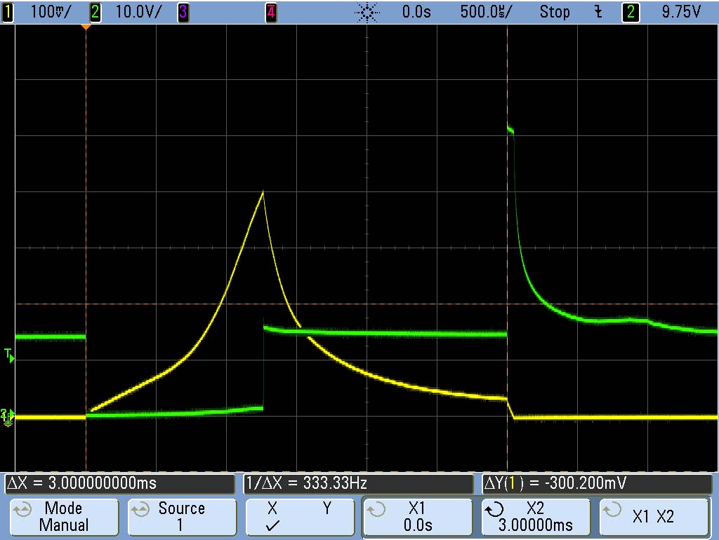

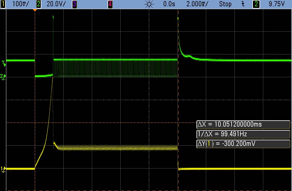

Postby Mazi on Sat Feb 28, 2009 12:32 am
Hm.. I can't find a glitch on current trace. .
Yellow trace is current measured with 1A/100mV 100MHz current probe. Green trace is connected close to injector apx 1.5m away from ECU.
Is it coincidence that current limiter is turned on exactly at 1280us?

Postby SprinterTRD on Mon Mar 02, 2009 8:13 am
The initial low time (1280US) is to make sure the pintal opens all the way. This time may change if the injector reaches peak current earlier and has a maximum timeout value incase the injector does not reach peak current. If you use negative numbers in the Injector current setting, the timeout value is allowed to be longer as some injectors build up current slowly.
This is described in the F1 help files.
