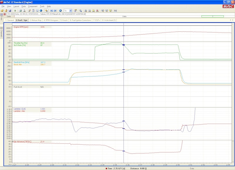

Engine leans out on turbo spooling up when running at 90-100% throttle.
Mapped lower loads with more or less steady constant load ok, however once started to map full throttle loads of 200 kpa and above keep getting lean lambda during turbo spool. The engine is Subaru STI 2.5 with Cosworth heads, 260-11.3 custom cams,Cosworth intake manifold, Greddy TD06 20G turbo, 4-1 exhaust manifold. Usually THxRPM fuel comp map used to solve the issue with few % added in the turbo spool rpm range (2000-4000 rpm), but not this time.
Screen shot below already has increased accell comp and +15% at 100% TH, but doesn't solve the problem, just some parts got richer.
Which comp strategy would be best suited for this case?
Best regards
Alex

Postby Alex B on Thu Jul 29, 2010 3:19 am
Martin,
The VE is raising steady over the boost levels. The problem is that under steady boost fuel is ok, but as soon as turbo spools up engine runs lean during this condition.
I did not consider the RPM ROC, however I tend to think that if used may interfere at some other operating points.
Yes I meant accel enrichment under accel comp. I scratched that idea since timeframe is to long for it.
We are using Bosch 1000cc injectors from T1 Race (aka Injector Dynamics).
Scott@FP
Yes, its a Subaru 2.5 STI with intake AVCS, Tomei custom spec 260-11.3 cams, Cosworth CNC heads with big valves, Cosworth intake manifold.
Current situation: We have solved the problem using Secondary load table THxRPM with 10% comp at WOT up to 3600rpm, although its a compromise solution with some overfueling and some underfueling operation, but nonetheless no La 1.0+ operation on spool up.

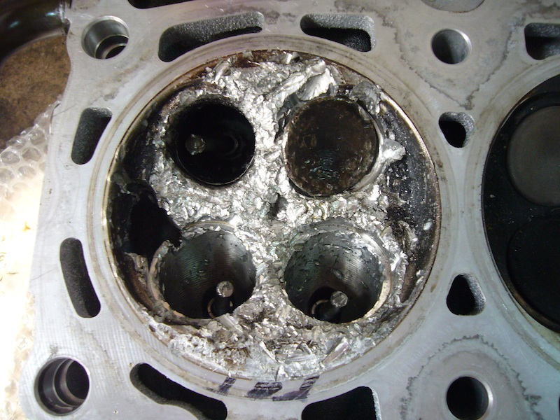

The final note is that after 1 week of usage by happy customer, engine blew :-( We think that valve seat became loose and started the chain reaction. This is second engine failure with Cosworth heads. First one was very similar. Have a look

Postby Steve M on Wed Aug 04, 2010 2:15 am
Answer from Cosworth on the big valve heads as posted on Naisoc
A friend of mine, running his 10 sec sti on a cosworth large valve head/cam kit have lost one of his cylinder number 2 intake valve after 8K miles of street use and some runs at the drag strip, here it is the answer from cosworth, wich makes sense, so you guys running larger valves, next time make sure you use the subaru procedure for installment, and turn the intake and ex LH head cam sprockets in the right direction, and turn them with the less angle possible and do not make them move, wich is difficult, but can be done..
so here it is
"The main issue is that it's difficult to keep the cam gears in the proper position when installing the belt and that you don't open intake and exhaust valves at the same time causing contact. As long as you follow the factory service manual instructions exactly, you will be fine. I've attached a PDF copy of the timing belt procedure. On page 5, they explain the importance of the steps and rotation directions. With +1mm valves and higher lift cams, the danger of valve to valve contact during timing belt installation is even greater.
once the valve is slightly bent, the higher spring rate and constant contact of the valve to the valve seat tries to straighten the valve. Plastic deformation sets in, like bending a paperclip back and forth, and then the valve head falls off causing failure. We inspected a number of these valves and the material showed evidence to support our diagnosis.
It's always number #2 that fails, so we're confident this is the problem. Some people argue about piston to valve contact with the AVCS full advanced or retarded, but we've bolted on a cutaway head and manually clocked the avcs cam to each extreme and never came close to piston to valve contact. If the cam timing is phased properly you don't have to worry about the AVCS.
