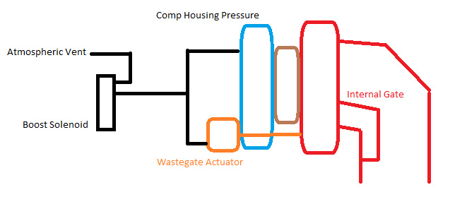

Recently I’ve removed the catalytic converter from my car and re-did my turbo drain due to a small leak. I replaced Turbo and BOV Vac lines whilst I was in there.
Now, since doing the work I’m having issues getting boost to generate with my setup. I’m hoping someone might be able to assist me in the problem as I’m stumped on it. I also removed a portion of intercooler piping and re-plumbed. I cannot hear any boost leak nor can I see any visible issues with the vac lines.
Please find attached Diagram of my current setup.

Boost solenoid is a Mitsubishi 2 wire 2 port setup. – Part Number
Previous workshop/tuner configured all the setup so I’m not even sure if it’s an ideal setup, however I assume it’s just a controlled bleed valve.

To have sure it's not a mechanical issue UNPLUG the waste gate hose.. you should get FULL! boost real quick, then you will have sure it's something on the solenoid or plumbing... if your solenoid go to a 100% duty you should have a decent amount of boost unless, it's not working or the hose going to the solenoid it's to small or the bleeding side it's too small.

Certainly the diagram you have drawn looks like a feasible setup that should allow you to control the boost from the ecu. But that doesnt mean your existing mapping is suitable after the changes you have made, which could explain the changes
