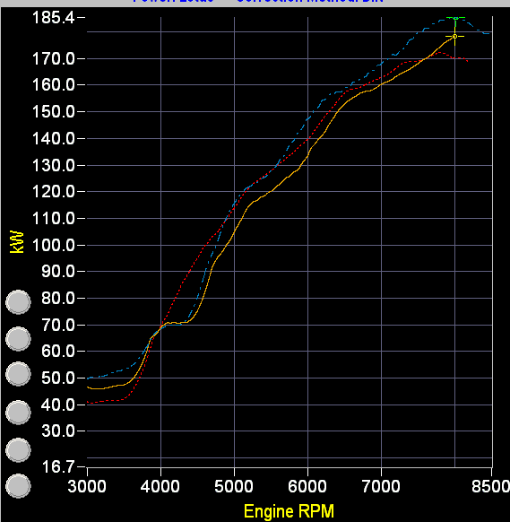

a little bit about Hi/Lo injection....
Engine is a 4Cylinder with ITBs
red = Exhaust change made to see back to back difference (Ignore)
Orange = Lo injection only, Lambda kept to aim value during run
Blue = Hi Injection only, Lambda kept to same aim value during run
Both were done back to back, directly after each other.
Hi Injectors are not in the runner at all, they are on a mounting point at the trumpet mouth about 30mm outside trumpet. Hi Injectors have a very wide spray pattern. Car was impossible to run in low trumpet airspeed sites with Hi only. Car would not idle with Hi injectors only at all.

Postby Polux RSV on Sun Feb 13, 2011 8:42 pm
Thanks for the info and graphs. The throttle body is vertical, hi injectors spraying on plates even at idle. On the first version I made last year, idle was very good, easy starting, smooth transitions, etc... I was also surprised it worked so good. We want to implement the same setup on the second bike.
