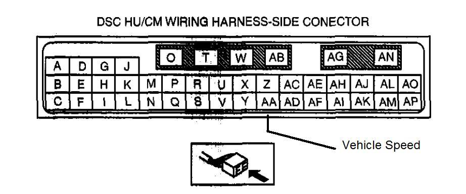

Postby Martin on Sat Aug 02, 2008 3:55 am
The pinouts i gave are for Certain bosch ABS pumps. Like the ones found in BMW`s. (those pins are the actual output pins on the ABS pump.
On the bosch pump like the one found on the RX8 pin AA is the Vehicle speed output

Postby EuroRace on Sat Aug 02, 2008 10:45 pm
I think I found the outputs, it seems like the in the center row of pins, # 40 & # 42 are the wheel speed outputs.

Postby EuroRace on Sun Aug 03, 2008 9:28 am
The wheels speed outputs are 40 & 42, works fine. You only get 1 front 1 rear signal.
