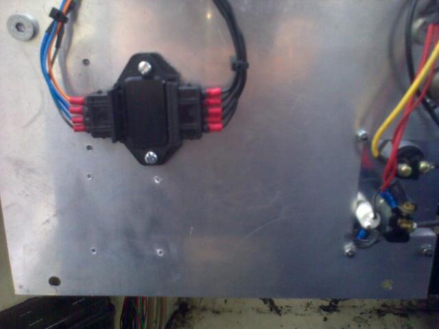

Postby ejenner on Mon Feb 01, 2010 9:10 pm
I'm using the Bosch 0 221 504 464 BMW ignition coils with an Audi/Bosch 4-way ignition module.
I'm not really much of a genius when it comes to the particularly high-tech stuff. I put these bits together using trial-and-error but they seem to work well with the M800.
