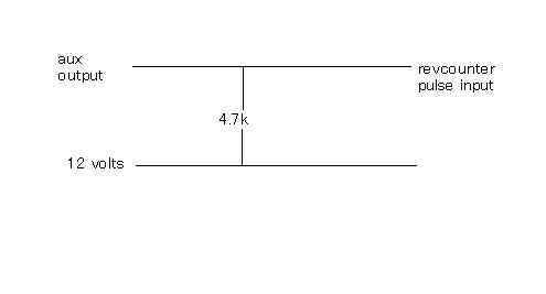

Hi ,Im just finishing wiring in my M400 to my 200sx S14a(silvia SR20DET) , but i dont know how to wire the AUX 4 output to the tacho, I know I need a resistor between 12v and the Aux 4 output, but i dont know what type or value.... Anyone done this before...? Thanks Gal

try a 4.7K to 12v, im some cases ive gone as low as 1K
.Aux4----------------------------------------recounter pulse input
. 4.7k
....................................................................12v

Postby Martin on Mon Jun 08, 2009 4:13 am
this drawing is more like it

Postby garykenward on Tue Jun 09, 2009 12:56 am
Cheers Martin....top man.... :D
