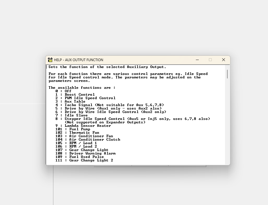

If you use an Aux Table to control the Aux Output, you can do this. Wire the NTC sensor into a free AT input (this is so that the changing resistance of the NTC sensor has a varying voltage that the ECU can read and use) then allocate that output to a User Channel, then use the output of the user channel as an axis on the Aux Table.

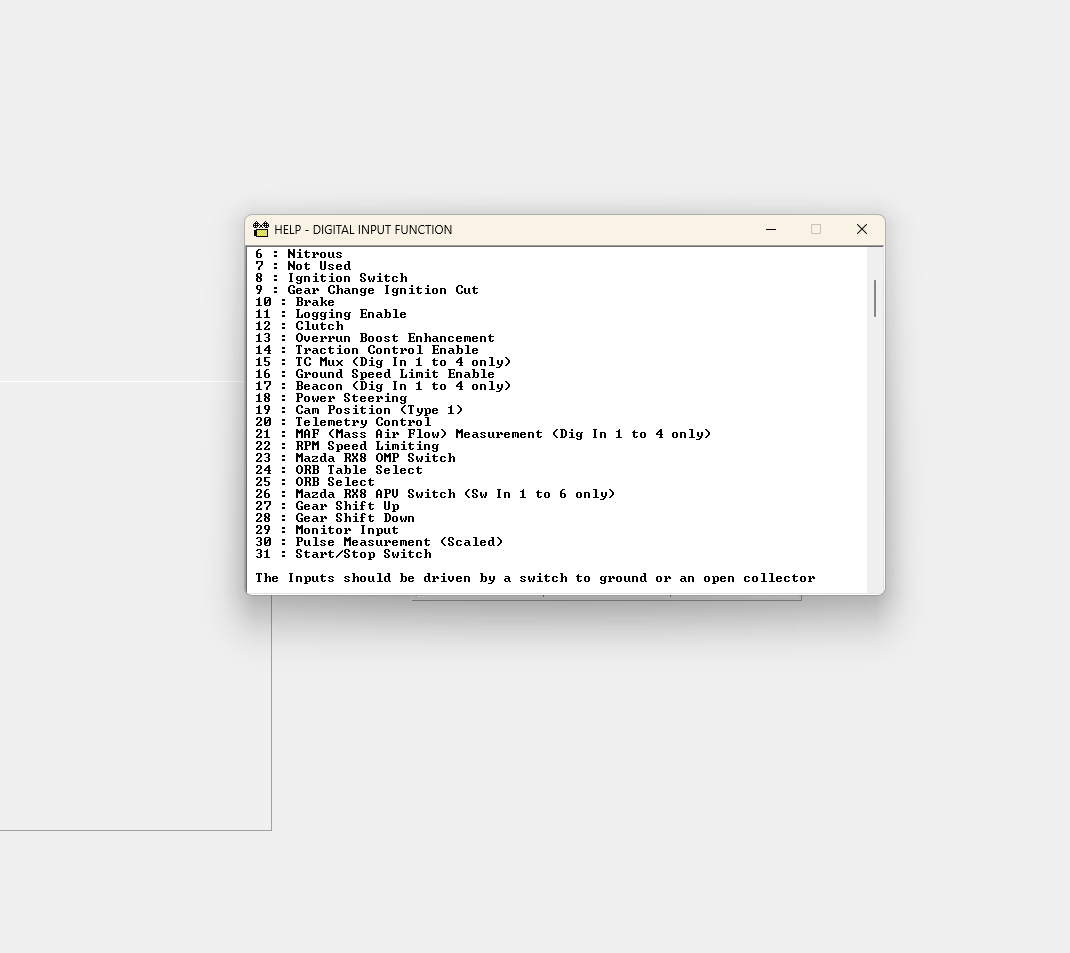

sorry if this seems silly , so i thought that the ntc would output a analogue signal so where do i find this input. thanks
Screenshot 2026-03-24 214302.png (30.07 KiB) Viewed 13 times
Screenshot 2026-03-24 214147.png (31.24 KiB) Viewed 13 times
