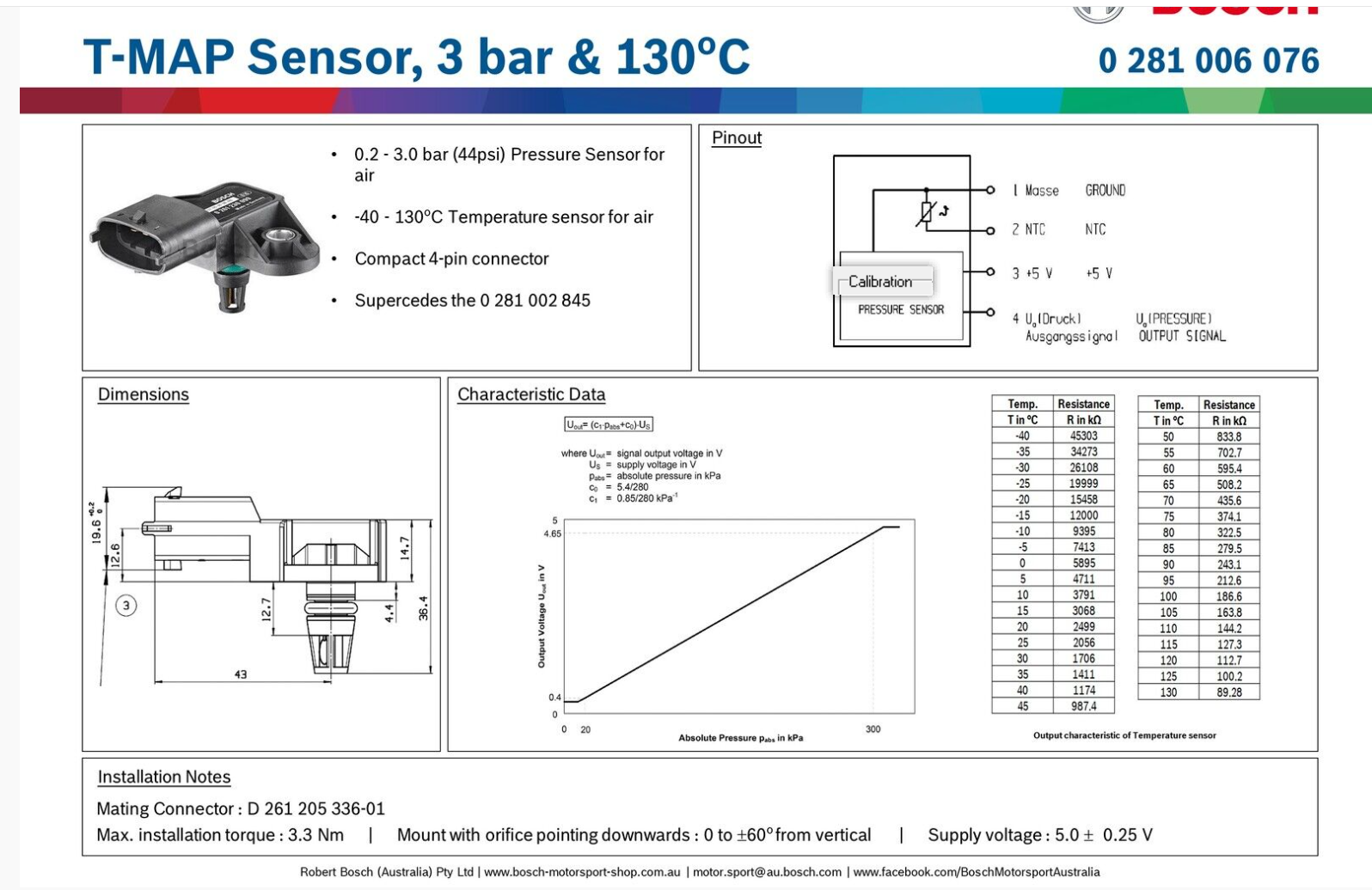

I have a BOSCH 0 281 006 076 in my hand. I want to connect it to the M800. In the calibration table of M800, the read value represents the voltage. How can I convert the read voltage into resistance to obtain the temperature for calibration?

Calibration data for you.

I want to pressure calibration.Thanks.

0.307V = 15kPaA
4.655V = 300kPaA
