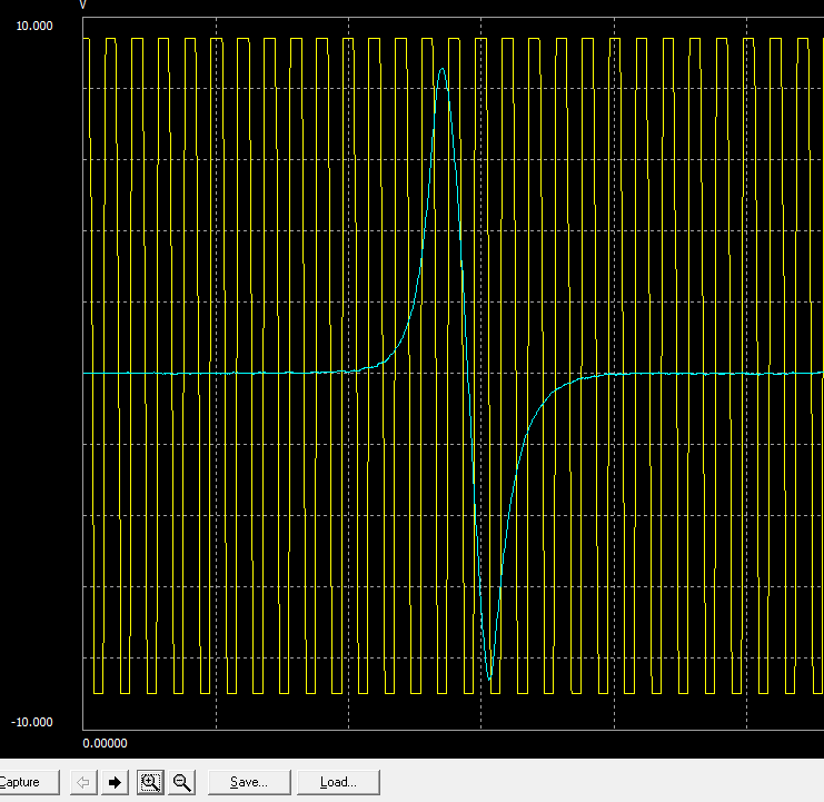

When you said the M400 has trouble with "two on top of each other", can you elaborate? Do you mean both crank and cam sync signals? (The crank signal is at 90 degrees BTC so these should not signal at the same time, if that is what you are referring to.

The screenshot is from a ref / sync capture. The yellow is the ref signal, blue is the sync signal. You can see the sync signal passes through zero volts in between the ref signals. It's my understanding that the M800 series ecus don't like the ref and sync signals to be right on top of each other as they pass zero.
Ref / sync capture is in ecu manager under utilities, you'll use this when setting yours up to verify what's occurring.
If milspecwiring says the sensor works with a magnet, it works with a magnet :ugeek:
