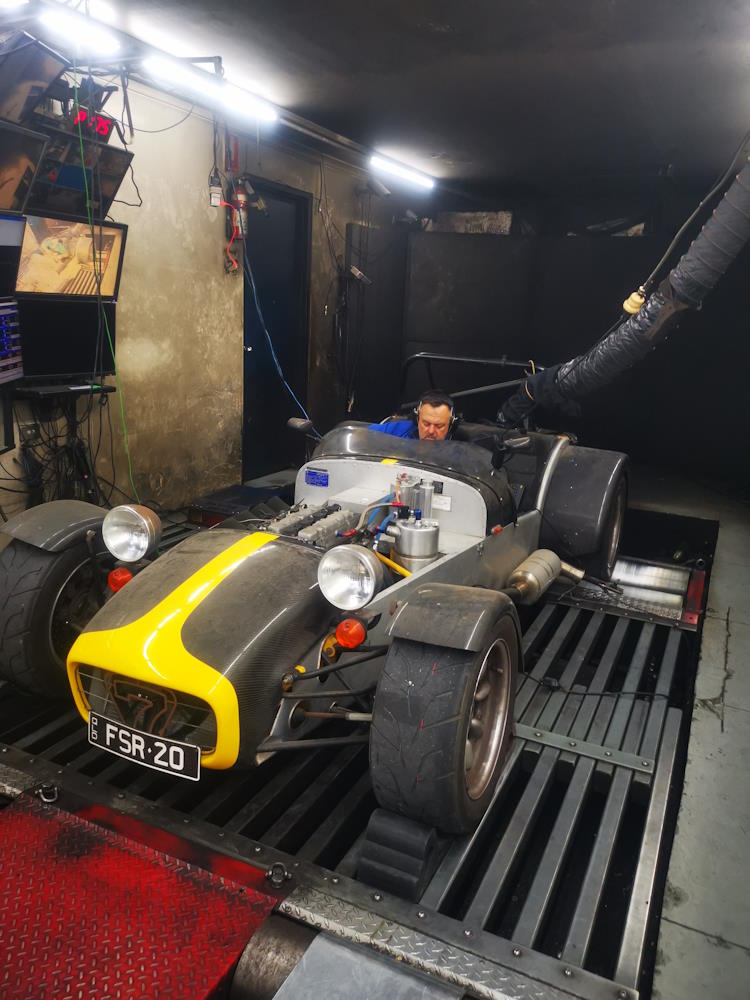

The car got the final power tune yesterday and the chap doing it also fixed the cold start. He ended up taking about 25% out one of the trims and that seemed to work well.
Managed to just crack 200 hp at the wheels!
