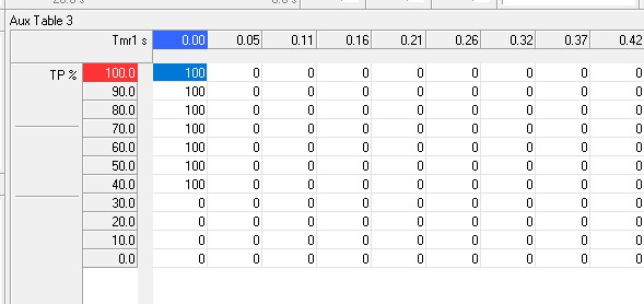

I found this, maybe a timer, in Aux Output 3, which only operates above 40% thottle. What does "100" mean, on?

Do you have ECU logged data from when you know you had these protections active in the ECU config? By default the ECU config is embedded in the log file, if you go to the tools menu and select view device configuration ECU manager will open the embedded configuration, if available. The file that ECU manager opens won't have a recognisable name, but you can "save as" and rename as convenient.
In very broad terms the 100 will usually mean on.

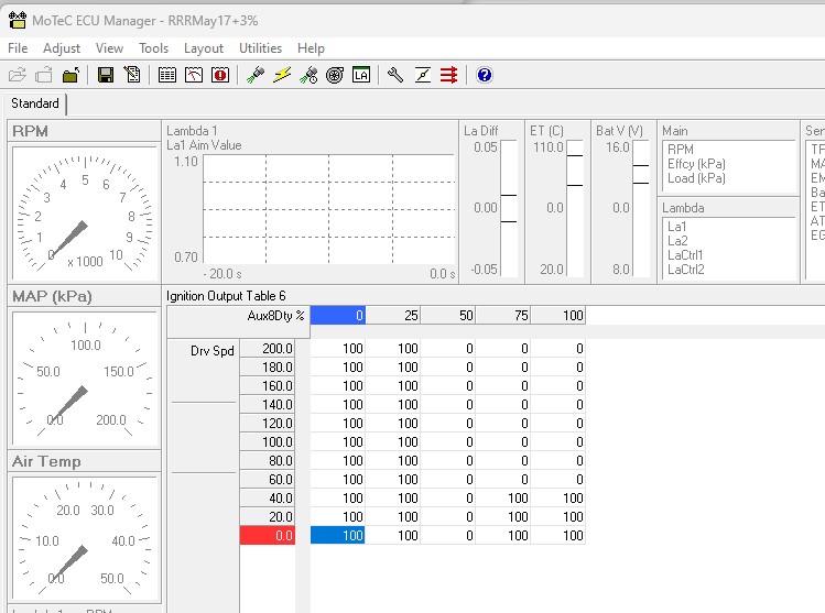

Is there some kind of map which shows which inputs, switches and outputs are connected? From trawling through the map I can see the following.
Aux out 1 goes to ignition duty 5 and 6. No idea what these are.
Aux out 3 is ON above 40% throttle. Maybe to do with anti-lag, but ORB has its own setting of 55%.
Aux out 6 goes to switched input 6, 100% with the throttle shut and 0% the rest of the time.
Aux out 7 is some kind of boost overrun switch.
Aux out 8 goes to Switched input 1 and ORB table set 2.
More notably...
Ign out 5 goes to Dig input 1, which is the gearchange button, and Ign out 6 goes to aux 8 duty which references drive speed. I'm confident this is related as I wouldn't want to engage 1st gear above 40mph and the table seems to show that. Even if I'm talking to myself here it's useful to make notes! :D
