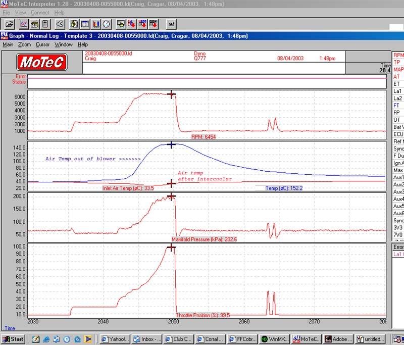

I don't recall updating the software after the attached datalog, so I'm pretty confident that the version would have been the latest as at 8/4/2003.
