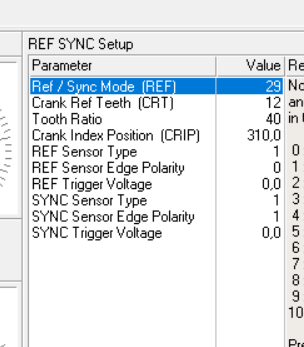

The video shows you have a Error with the Sync sensor. I would do a REF/Sync capture with the spark plugs removed and the injectors not connected. then set the REF/ parameters.

the ref sync setup is for my honda correctly set

On my working K20 setups, I have both Ref and Sync Sensor Edge Polarity set to 1 (Rising Edge)
Also, the Ref and Sync Filter tables both have 124 for 0 & 500 RPM
Posts: 1441
