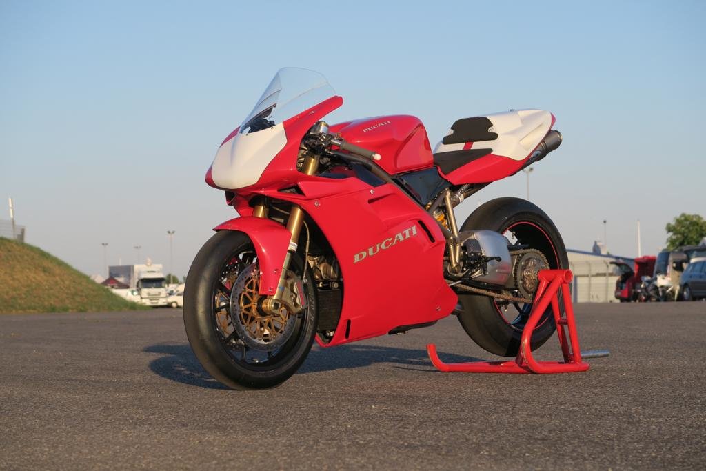

I have a Motec M800 + SDL Dash/Logger on a Ducati 1098 Engine in a 916 Chassis.
After a few Rides, the Bikes runs good, but not perfect. The last Optimizations i would do on the Racetrack.

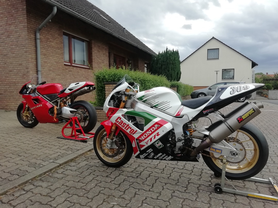

And 2 Pics of the Bike.
